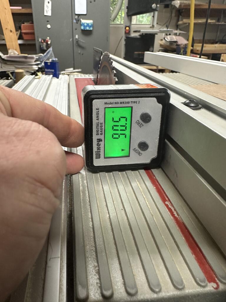

    I just did your experiment, Zeroed the gauge on the table and then checked the face of the fence and I got 89.81°
    That's close enough for me. The typical claimed accuracy of these digital gauges is usually +/- 0.2 degrees.

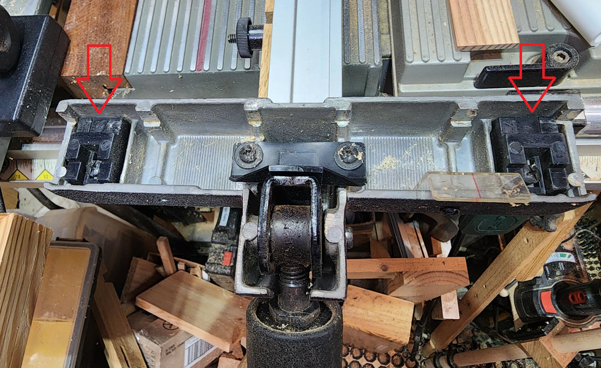

            This photo is the bottom of the rip fence assembly T-block.
            The two slides pointed at by the arrows can be used to tilt the rip fence slightly. I believe one can be unscrewed and a small shim inserted between it and the T-block. My calculation shows them to be 7.25" apart, a shim under one side of 0.063 " or 1/16th of an inch will tilt the assembly 0.5 degrees. The direction of tilt adjustment depends on which side you shim; you did not specify which way it leaned. you should shim the side to which it leans.

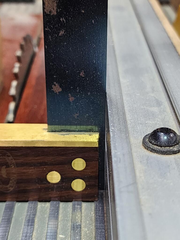

            as those digital gauges have a possible +/-0.2° error, I suggest instead using a machinists square to check the table to rip fence angle.
            Machinists squares are basically two pieces of steel fastened together permanently is a very accurate 90° angle. You can get them 2, 3, 4,5, 6 inches and they are relatively inexpensive (under $10 bucks) and their angles are usually super accurate using jigs when manufactured. They only do one angle and they are accurate like I say. Even the cheap ones are accurate.
            Click image for larger version  Name:	image.png Views:	0 Size:	446.2 KB ID:	863291
            Click image for larger version  Name:	image.png Views:	0 Size:	78.3 KB ID:	863292
            Typical 90 degree angle accuracy will be .001 to .004 degrees.
            This will eliminate the accuracy of the digital gauge.
            Typically the human eye can spot a gap of .001", on a 2 inch high fence a .001" gap is about .03 degrees.
            I have a 3x4" and a 4x6" one i use for checking rip, Miter, Jointer, and other fences and drill press and bandsaw perpendiculars

                  using a machinists square referenced to the table top, 1/2 degrees fence lean will result in a 0.017" gap at the top or bottom, depending on which way it leans. .017" is right at around 1/164th inch. Certainly easily discernable to the human eye.
                  When using a machinist square to check square between items you want to be square, I find it helpful to shift the square back and forth between flush with one side and then flush with the other side, it helps visualize the size of the gap. When perfectly square, there will be no shift between flush to either side.

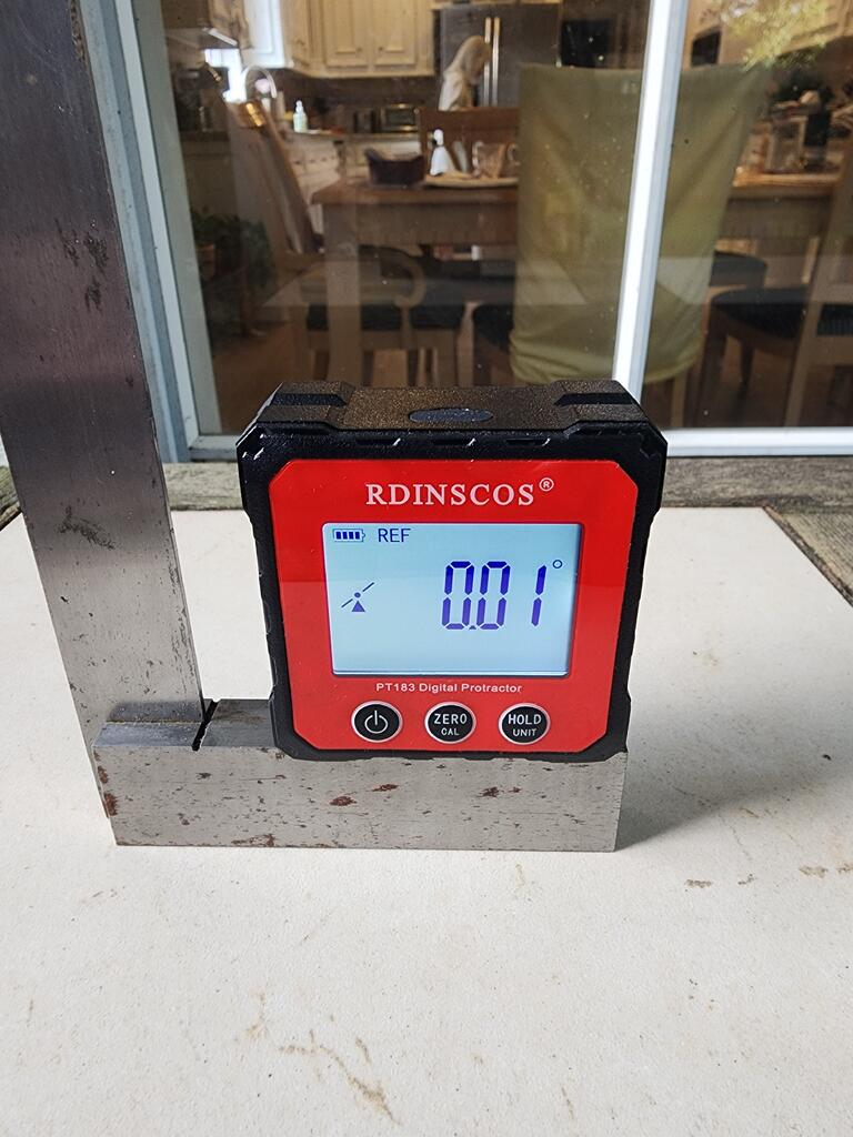

                      I decided to do a test.
                      First I place a machinists square on the table and set the base of the digital Angle gauge on the wide leg and zeroed it.
                      Click image for larger version  Name:	image.png Views:	0 Size:	820.8 KB ID:	863313

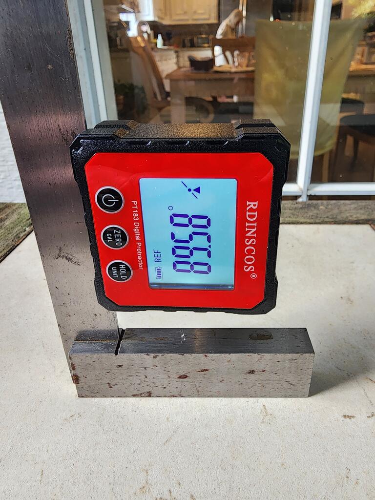

                      I then took the gauge and placed the same reference base against the vertical leg. It measured 89.58°. This is 0.4° from the expected 90°
                      Click image for larger version  Name:	1000014304.jpg Views:	0 Size:	121.5 KB ID:	863314
                      My conclusion: I tend to trust the machinists gauge as the claimed accuracy is about 100x times better. So that puts a real question mark on the claimed accuracy of the digital angle gauge of +/-0.2°
                        LCHIEN commented
                        maybe that speck of sawdust on the bottom leg is the source of the error?

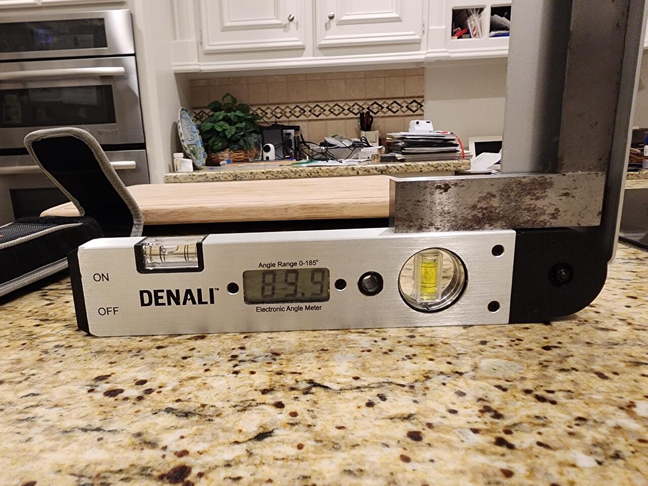

                      Fwiw, my protractor says 89.9°.
