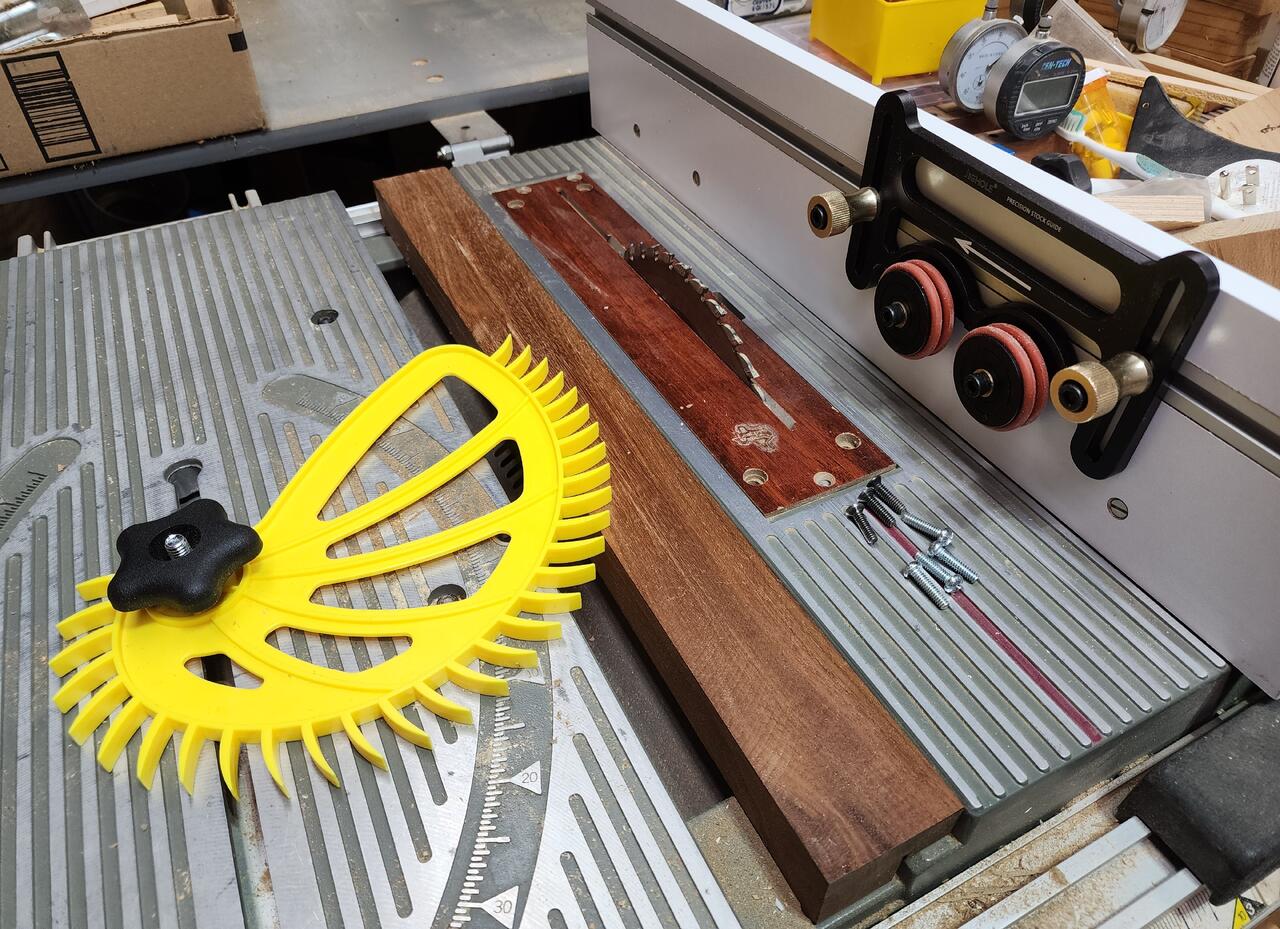

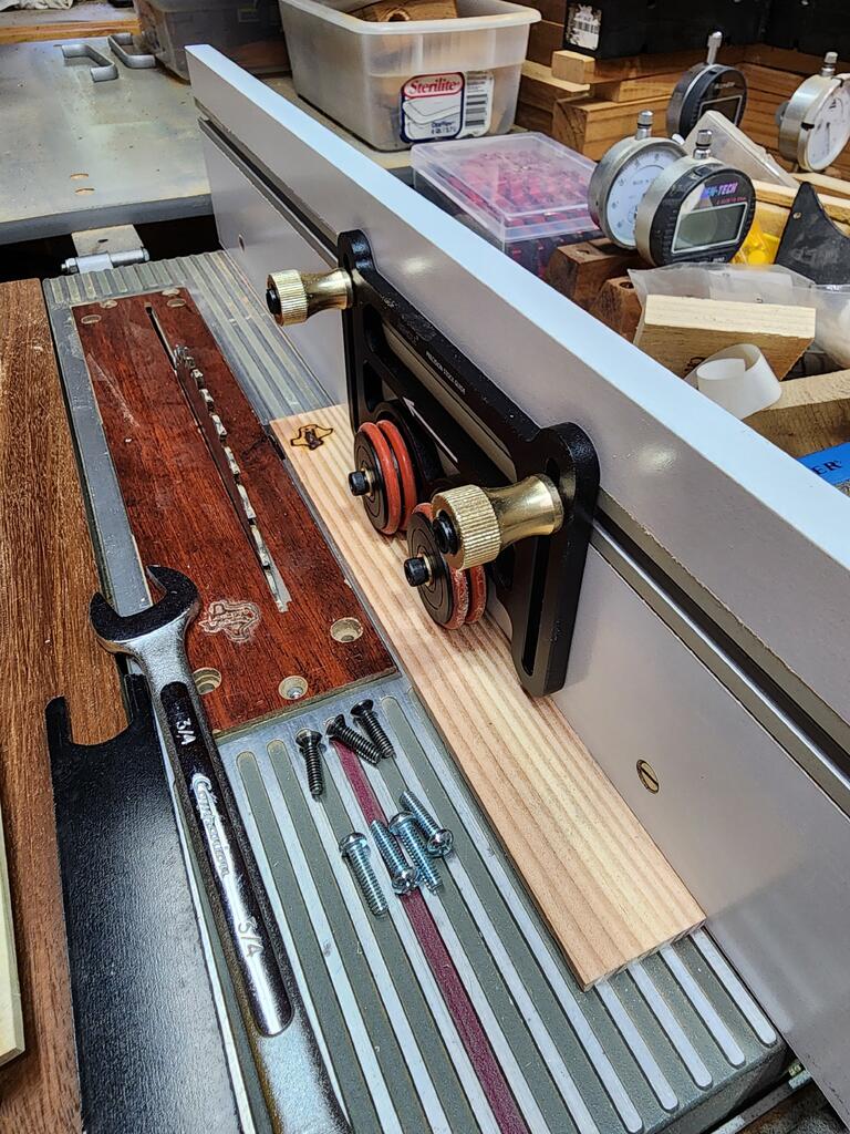

    Haven't tried them yet, I need a project.
    It's a high fence as well as a stock guide.
    Click image for larger version  Name:	20260321_144320.jpg Views:	0 Size:	143.9 KB ID:	862828
    Click image for larger version  Name:	20260321_144327.jpg Views:	0 Size:	175.9 KB ID:	862829
    Can slide the SMT over all the way to the main table to get close featherboarding.

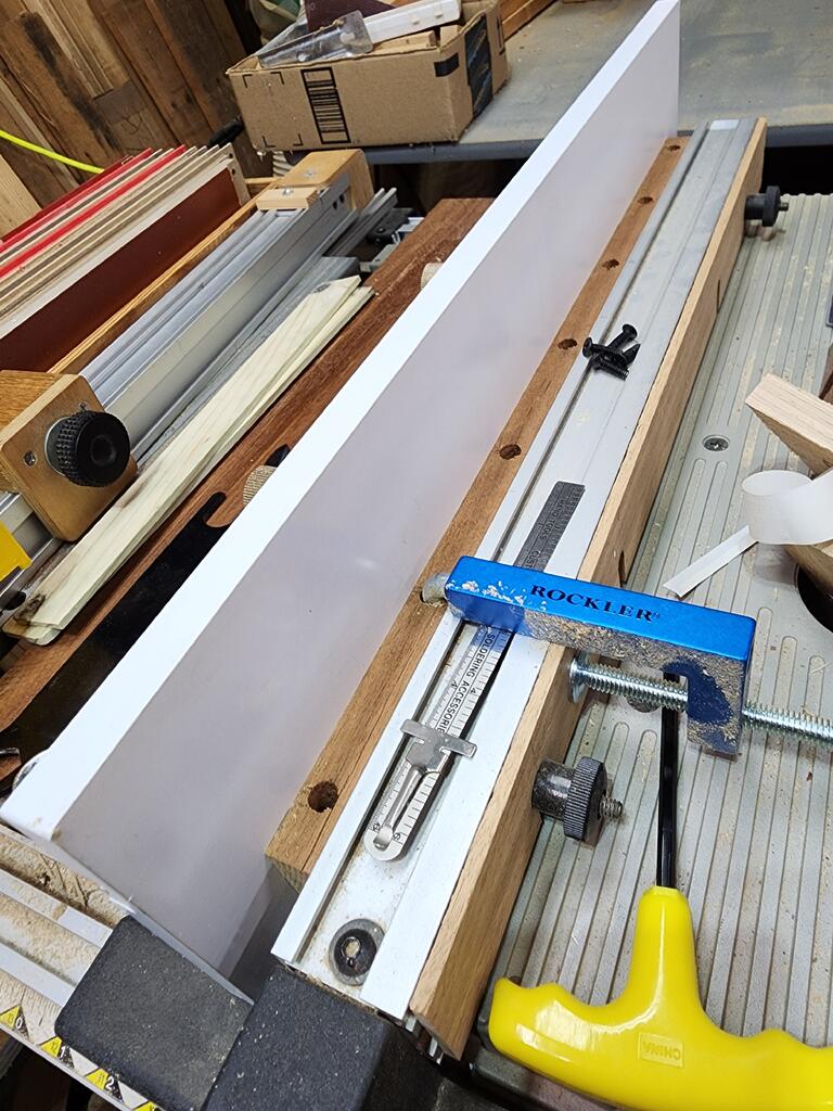

    And an alternate:
    Click image for larger version  Name:	20260322_104120.jpg Views:	0 Size:	260.3 KB ID:	862845

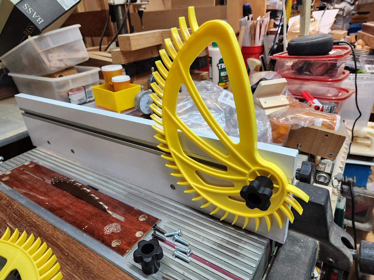

    I have two old Rockler feather boards. One is set up as a feather board, and the other is assembled reversed and used mounted to a T-track mounted on the BT3000 fence as hold-down and anti-kickback. I also fit the feather boards to the router in the BT3000 for holding side ways or down. Mine are the older black ones with the 3" rectangular miter slide locks. Unbelievably, neither have saw-blade or router bit marks in them!

    I like the looks of the stock guide, Loring. Can't wait for a user report on that. Hopefully the wheels have a little toe to drive the stock against the fence?
    Are the feather boards sprung so they self adjust?
      LCHIEN commented
      yes, the rollers have slight toe in towards the fence.
      The featherboards "spring" is in the fingers.
    • 22098
    Here is the toe-in of the wheels in the stock hold down, visible. 2-3 degrees, anyway

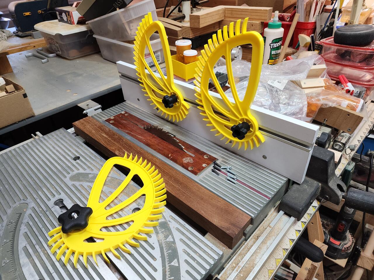

    Dual stock guides:
