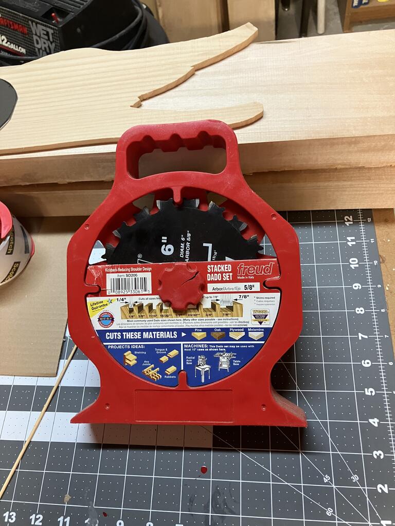

How do you find it? I think they are quick to set up instead of having to deal with adding up stacks.
Do you find it dangerous in any way (moreso than a stacked dado which is pretty dangerous).

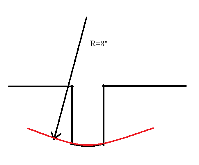

Makes an ever so slightly rounded bottom (exaggerated for effect)
I calculate the edge depth to center depth difference of the bottom to be .021 inches for a 6" wobble dado and a 1/2" wide groove. That's less than 1/32 of an inch and a bit more than 1/64th.
