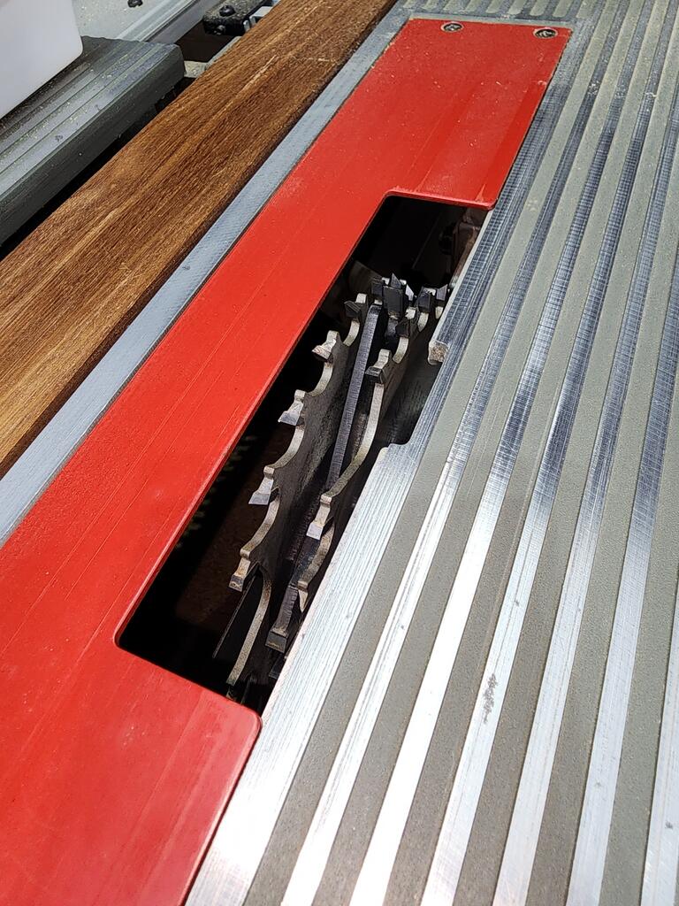

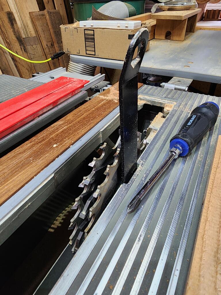

had to change to a dado blade today - time for some saw maintenance
    • 21698

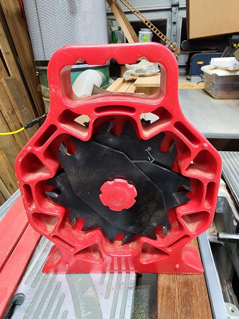

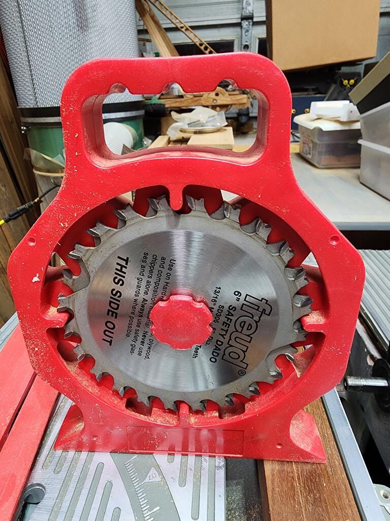

    Freud SD306 six inch stack dado.
    been a good dado for me.
    I have an 8-inch but found out the hard way that it doesn't fit over 1/2" stack on the BT3000.
    Anyone with a cabinet saw want to buy a 8" Freud dado set, barely used?
    Click image for larger version  Name:	20240427_234322.jpg Views:	17 Size:	159.5 KB ID:	858678 Click image for larger version  Name:	20240427_234330.jpg Views:	17 Size:	152.5 KB ID:	858677 Click image for larger version  Name:	20240427_135450.jpg Views:	17 Size:	131.1 KB ID:	858676 Click image for larger version  Name:	20240427_135457.jpg Views:	17 Size:	151.2 KB ID:	858671
    Click image for larger version  Name:	20240427_213821.jpg Views:	17 Size:	155.9 KB ID:	858672

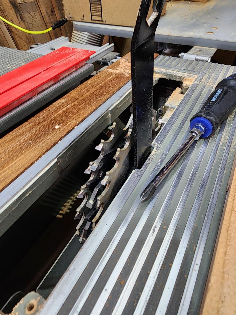

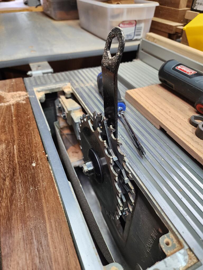

    Then I cleaned the saw, vacuuming all the dust from the corners of the blade shroud area (there's a well under the riving knife mount that catches dust)
    Blew out some more with the air gun. Then I lubed the motor mount raising and lowering ways where the shims are with a generous amount of paste wax. They've lasted 24 years...

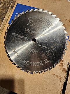

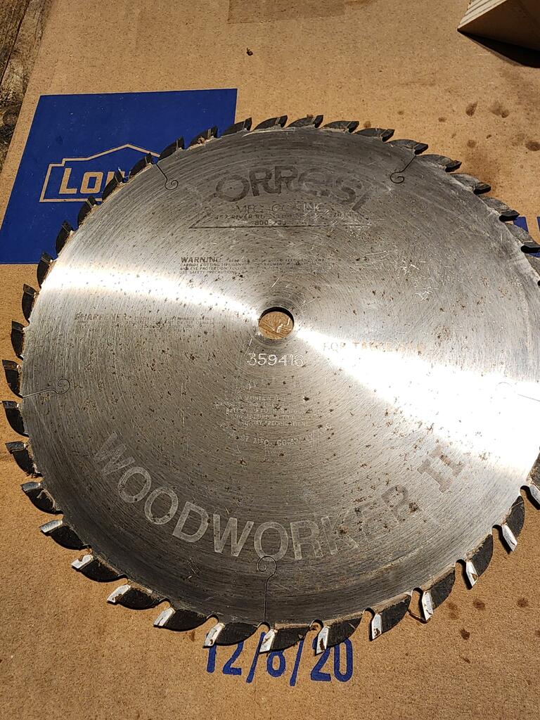

    Then I cleaned the blade... Last year I cut some vinyl shelf mats for the remodeled kitchen, I took the rolls from the store and simply cut them as a roll on the saw to the correct width for our shelves. Worked well except it left a thin melted coating on the side of my blade. I gave it a good scrubbing and found that Simple Green loosened it enough to scratch it off with my fingernail and then a small brass brush. Looks much better now.
    Click image for larger version  Name:	20240428_002308.jpg Views:	17 Size:	186.1 KB ID:	858674 Click image for larger version  Name:	20240428_002957.jpg Views:	17 Size:	191.2 KB ID:	858675
