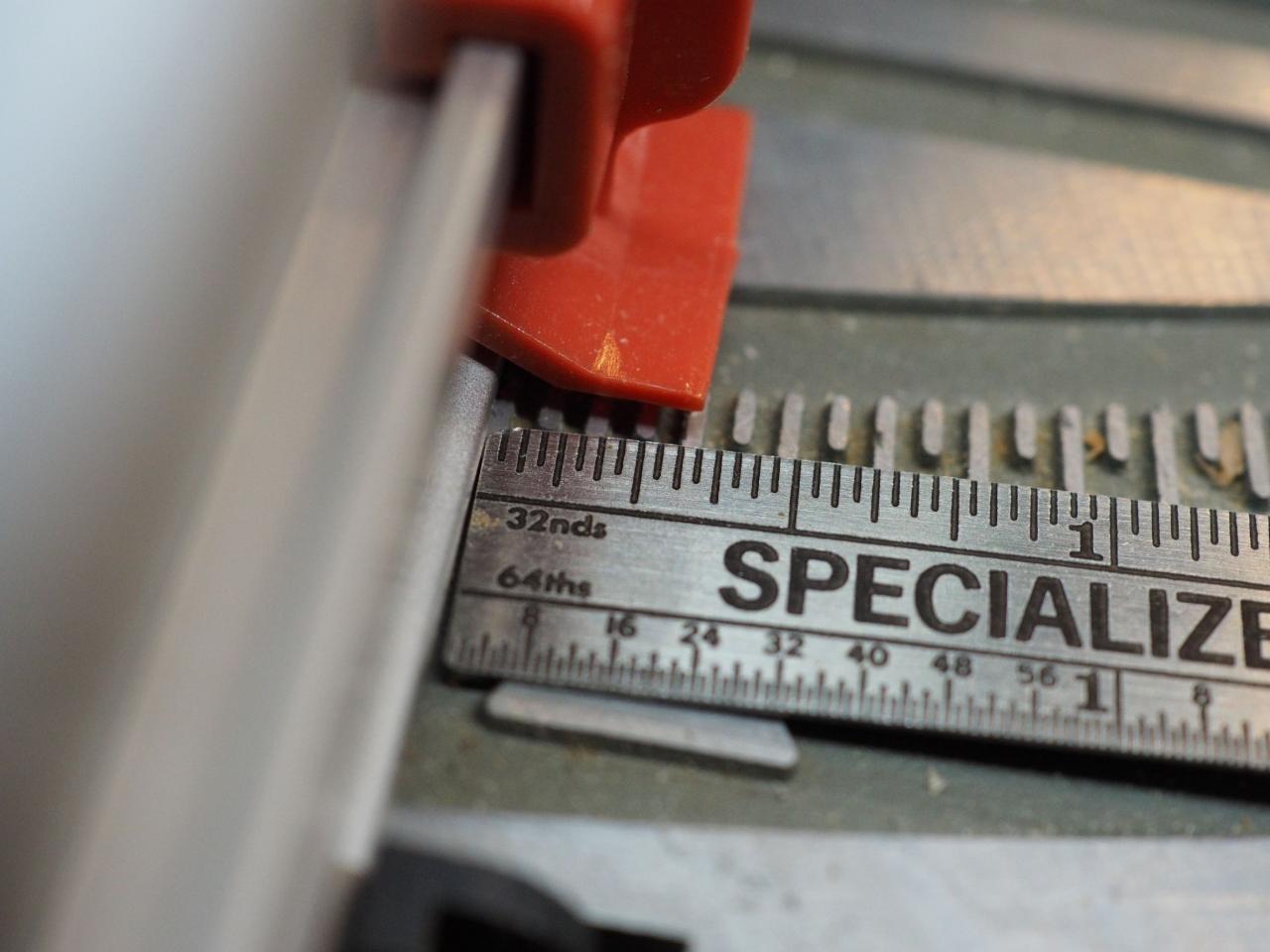

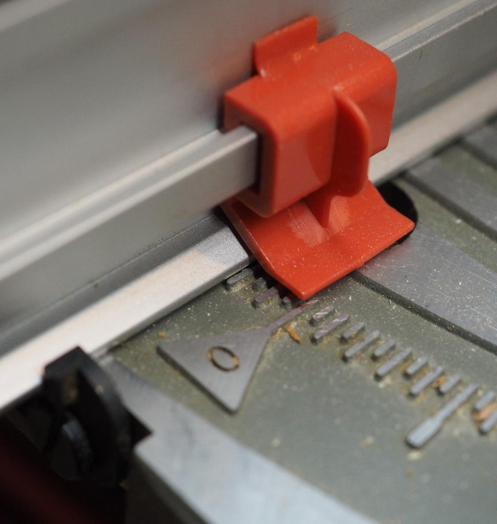

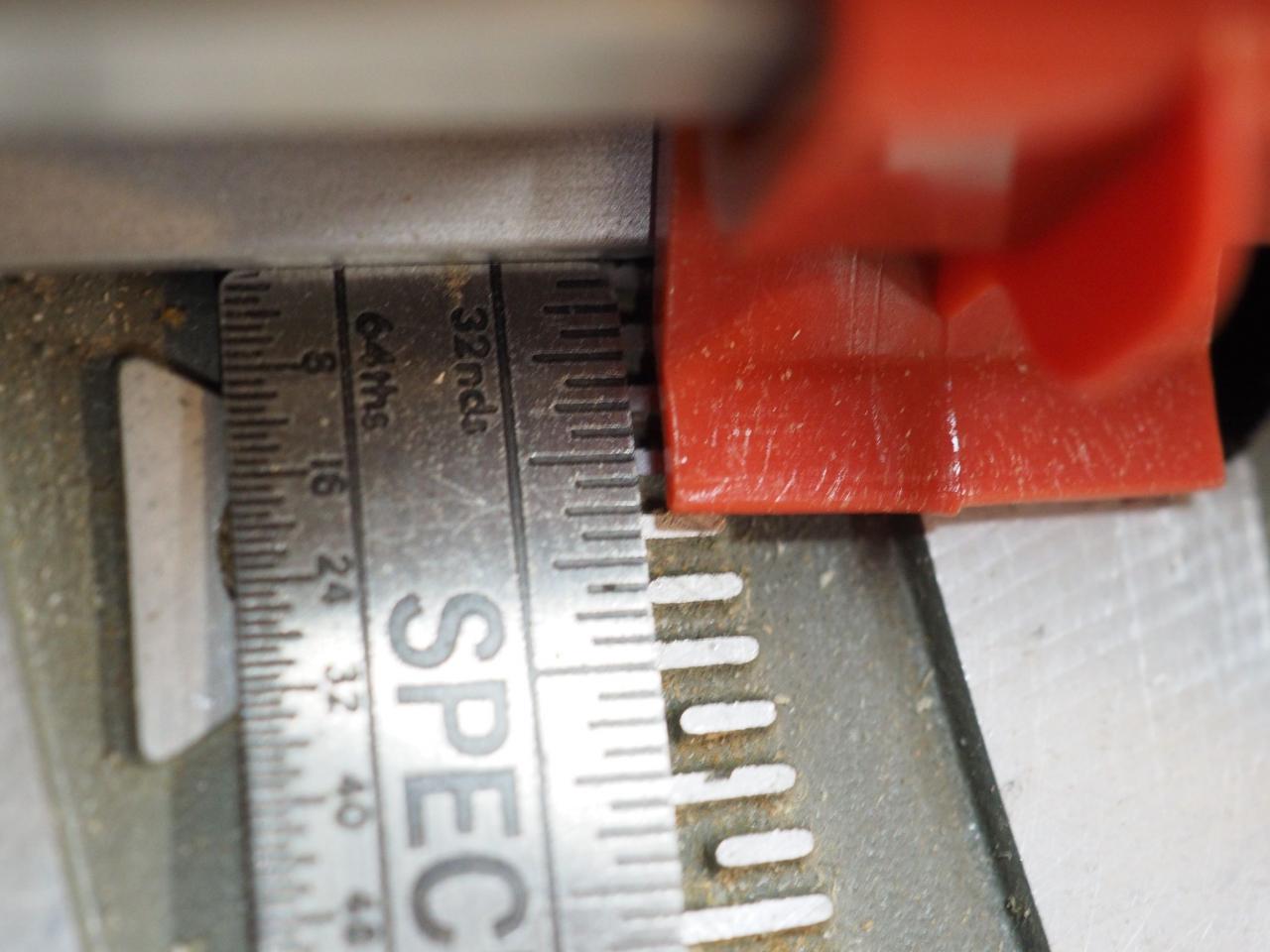

      I hope the pictures attached will help. I could live w/o the quick stop. But the miter indicator seems really useful. Some pictures have a ruler to help gauge how far out the tab sticks. Looks like you could make something that fits the large track on the back side of the fence and can be screwed to clamp it or loosened to slide and have the tab out the bottom/back side.
      Good luck.

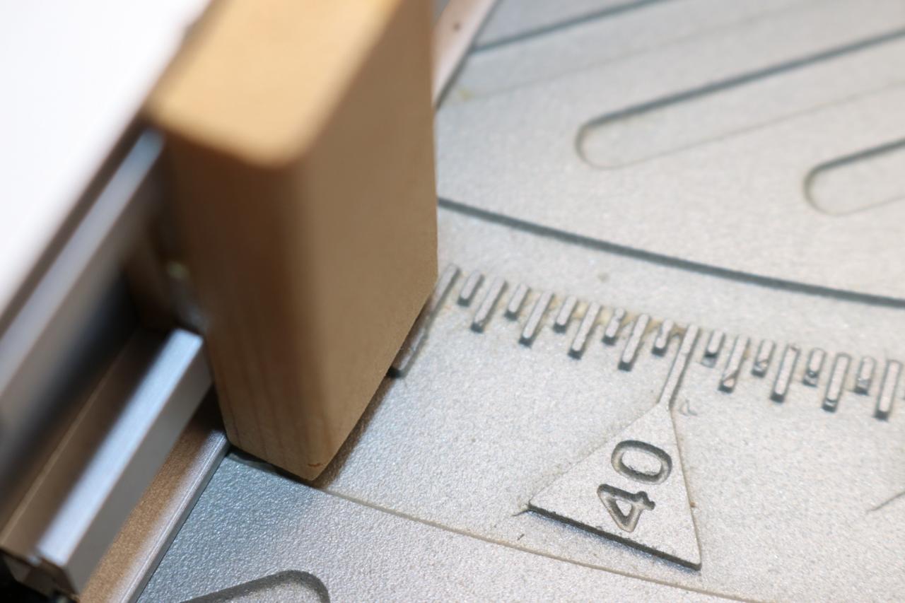

              Well actually this should be pretty easy to make just out of some wood scraps. After reading that you have no means to cut, tap, and thread a piece of aluminum you could just make it from strips of wood.
              I went out and grabbed my SMT fence and a couple of slivers from the scrap box. Found one that was thin enough to fit that inside channel (1/8 - inch) thick x 1.04 width x 3/4 (not critical). Glue to that a second piece about 3/32 - inch thick and the same width as the first piece and on top of that glue a piece that is 0.323 thick. You would now have a pointer that is the right dimension, no metal to deal with and it will slide into the end of the channel and can be moved along the fence as needed. Just glued up wood strips, but there is really no stress put on it that should cause it to break.

                  Don't mean to be a trouble maker, but, unless the third piece you call .323 thick is pulled tightly against the face of the fence it will be a poor reference to the angle marker because of the back and forth slop.
                  If you can't make a metal piece then you have to make a wood piece thick enough from your part 1 and 2 to hold a few threads of a small wood screw needed to pull the third piece flush against the fence.
                  I measured the lip at 0.105" thick so your second piece glued to the part in the track has got to be less than 0.100" thick. to be able to pull the third indicator piece flush against the face
                  And it can't all be one piece.

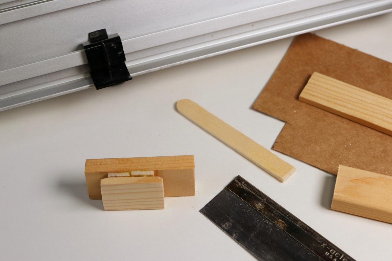

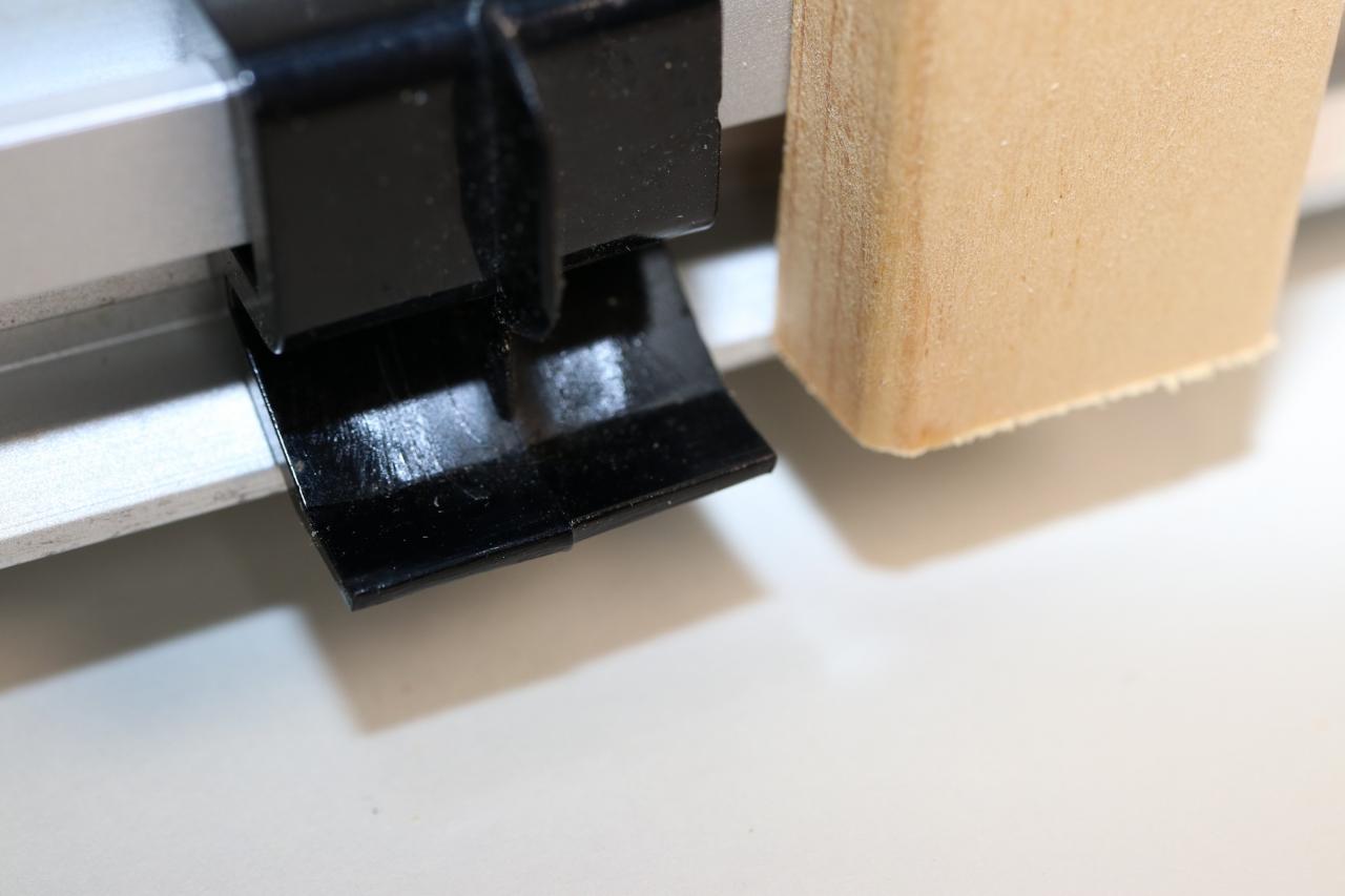

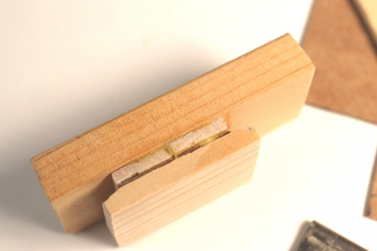

                    So instead of spending any time drawing something, I just decided to cut and glue some scraps together to see if my idea would even come close to working. This would be pretty crude, so let's just call it what it is, a quick and dirty prototype.
                    It was too cold to go out to the shed and I figured the time it would take me for this simple piece wasn't worth igniting the heater. So, I took some 3/4 edge cuts that I had in my scrap barrel, found a piece that would fit the fence slot and cut it to snugly fit vertically in the slot. I had to do a little sanding to get it to fit and still slide along the length of the channel.
                    Second step was to fit a piece in the open area of the channel to bring it up level with the face. None of the scraps was thin enough, so I grabbed a Popsicle stick (yep, that's what it was) and found it was almost the thickness I needed, but not quite. So, I cut a small square from a cardboard product package, glued it to the 1st piece as it sat in the slot. Then I cut the Popsicle stick to make two 3/4 long strips and glued those on top of the card board. That brought the piece up level with the face.
                    Third step, I found another 3/4 wide scrap that was just slightly thicker than I needed. I cut it to a length that was slightly less than the height of the miter fence and then glued it to the assembly that was still in the channel. I adjusted it so that it came down even with the OEM indicator. A few minutes later the glue had set enough for me to move.
                    At this point I took a few picture and moved it back and forth in the channel. Like your initial wood indicator, mine too was just a bit too thick and I took a file and beveled the bottom edge.
                    So, about that concern where a screw is necessary to clamp the indicator to the front of the fence. I'll have to go to the shed and place the fence on my BT and do some checking. Right now, there is very little slop. The indicator slides okay and with a feeler gauge I can snuggly fit 0.003 behind it. I'm not sure really how much that would throw an angle setting off.
                    I don't do a lot of angle cutting on the table saw, mostly 90-degree cross cuts and for that there's the flip-up stop. If the .003 is too much, I can simply slide the indicator out and stick some tape behind it and hopefully that won't be thick enough to cause the indicator not to slide.
                    Bottom line, I did this in my basement work area, cutting the scraps to length with my X-acto razor saw and used some sandpaper over which I slid the small pieces. It took about a half-hour and as mentioned there's very little play. Placing them side by side on the fence, the wood indictor is very close to the OEM one, with the only real difference being my quick sanding of the bevel. Overall, if I had been making a 'final' I would have tried to be more precise.
                    So Dell, this isn't pretty as nothings sanded or fitted well, as I said, a quick and dirty prototype. It was minimal work with minimal tools. I think it might work and I'll attempt to check the accuracy tomorrow.
                    Please feel free to critique.
                    Click image for larger version  Name:	IMG_1723r.jpg Views:	0 Size:	80.9 KB ID:	841627Click image for larger version  Name:	IMG_1725r.jpg Views:	0 Size:	83.6 KB ID:	841628Click image for larger version  Name:	IMG_1720r.jpg Views:	0 Size:	60.7 KB ID:	841629Click image for larger version  Name:	IMG_1713r.jpg Views:	0 Size:	58.0 KB ID:	841630

                      I think if, as you did, fine tuning the meat of the sandwich might make it close enough so there's no slop in the indicator.
                      Perhaps making the meat a flexible material with a little give and a tiny bit thinner than the lip could actually make a pointer with a little stay in place power but easily slidable and no slop.
                      Good job. There's almost nothing that can't be improved on.
                        • 2811
                        The two things a don't like about it (beyond it's being just crude) is that I put too much of a bevel on it and it falls short of the marking. The second is that it casts a shadow across the table mark. So I'll do it again.
                        On the plus side, there is no slop, there's only 0.003 play and anything less than that might restrict it's ability to slide, but I'll find some time tomorrow to play some more.
                        The one problem that I had though was that the miter fence from my BTS 21 is not exactly the same as the one on my BT3100. Looks like the same extrusion, and since it was loose on the shelf, that's what I grabbed to make the prototype. So I went to the shed this morning and the wood indicator would not fit on the BT3100 SMT fence and therefore I needed to do some sanding to make the insert shorter. For a quick test I just used the shorter miter fence (BTS21). Checked it at 90- and 45-degrees and it worked fine. I have a precision stainless steel triangle to check the angles between the blade and the fence and they are precise, bearing in mind that the wood indicator falls just to the left of the marking because I sanded a bit too much on the bevel.
                        Thinking further, instead of making this a 3-piece hack job, I could well just use a piece that equals the total thickness from the bottom of the channel to the top surface of the fence, and then use the router table to machine off the edges so it fits the channel. Then just glue the top, marker piece, on to that. The one thing I noticed with your design was that you've slotted the marker so it appears vertically adjustable, while my copy is fixed, because I've glued it. I'll have to think about that.
