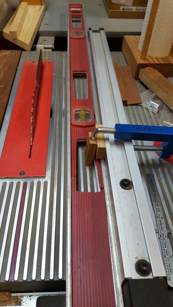

      • 22050
      Here's what I do when needing a long rip fence... clamp a 4-foot level to the rip fence. I use the usual hole in the level to clamp it to the existing rip fence.
