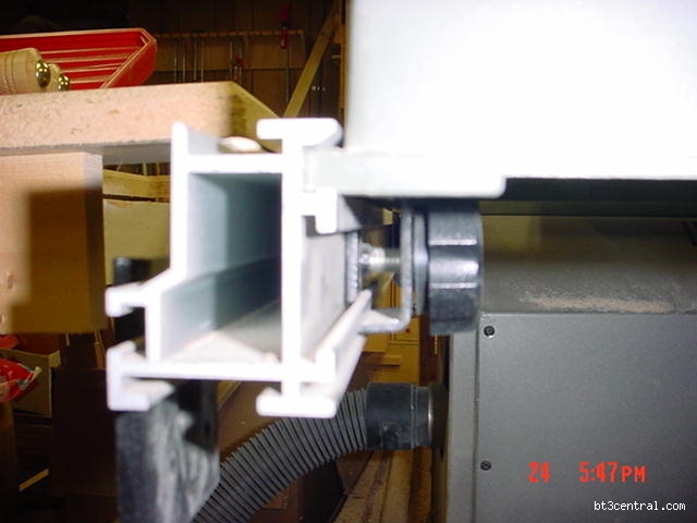

    What brand router will you be using? If it is a Ryobi or a Ryobi built Craftsman branded router the supplied plate will work as is. The first step is to mount your router to the plate, then you mount the plate to the accessory table. Secure the acc. table to the back rail with the supplied rear clamp.
    It is a small "L" shaped bracket. Do not attempt to use the router without it as the vibration will cause your router to move the acc table.
    Many users mount the router fence pieces on the right side of the rip fence and then stand on the end of the saw facing the right side. Feed from right to left if you do this.
    Most have found the kit supplied fence parts too small to be of much use and just build their own fence.
