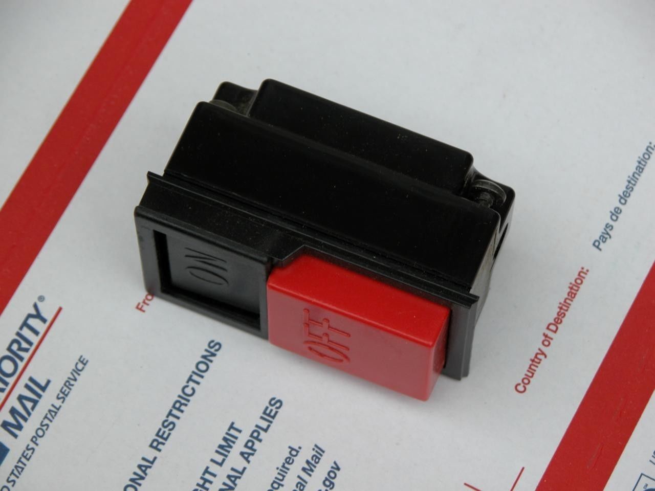

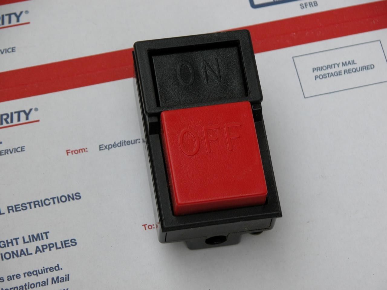

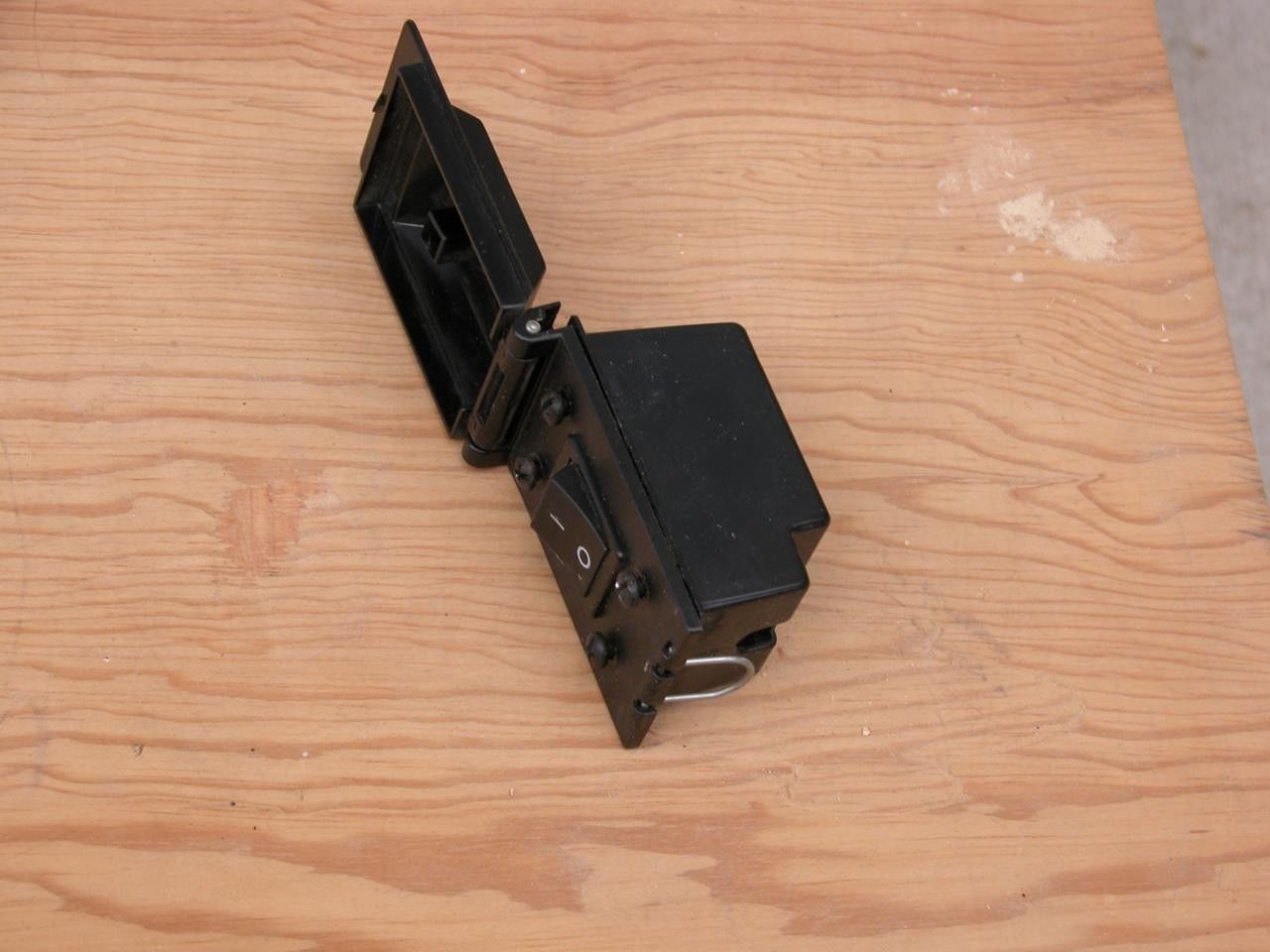

                I am not sure. Here are a few pictures of the switch.
                Cost would just be to mail it to you.
                Randy

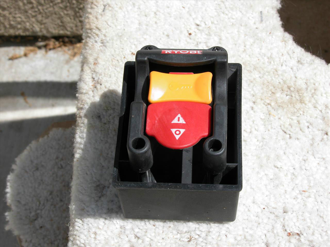

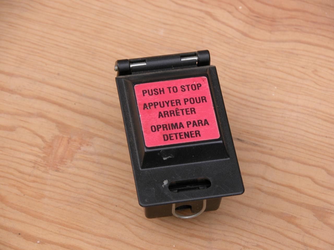

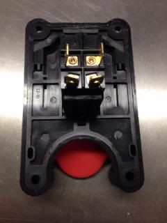

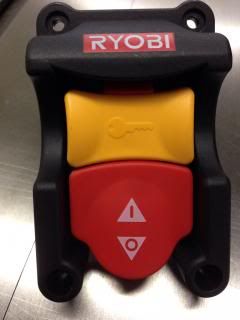

                    Sorry, the original switch is two-buttons - black (on) and red (off). (2 pics) That one was recalled.
                    The second generation BT3000 switch is the rocker switch with the hinged cover and lock loop. (3 pics)
                    They all fit the same hole as well as the BT3000 switches (1 pic - mounting), as far as I know...
                    Last pic is of the BT3100 switch.

                            I meant the BT3000 hinged cover switch won't fit the BT3100. Is that how Wayne explained it?
                            • rcplaneguy
                              • Nov 2012
                              • 37
                              I have a BT3100 with a black rocker switch covered by a hinged cover (which has a red label on the cover). And I have a BT3100-1 which has the red paddle switch with yellow safety key. I know for a fact that they do not interchange. The switch with a cover is smaller, the metal front of the saw has a smaller rectangular hole cut in, and the plastic box the switch fits in is smaller.
