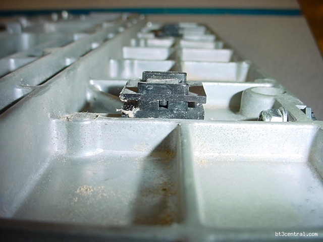

          • 4715
          Check that the glide on that side in the rear is not broken. It should look like this:

            Broken Glide
            Cool - let me look - thanks for the post - Keeping my fingers crossed. Hoping it is not - seems getting parts is harder and harder. I may end up with a new saw :-(
