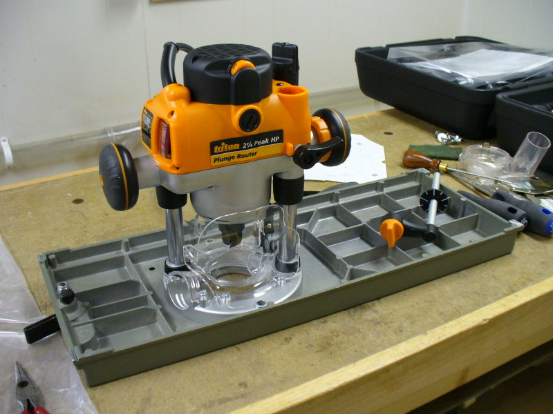

            I mounted a Triton 2.25HP router on my BT3000 quite some time ago,
            worked out fine:
            Here are some pictures I took at that time:

            cheers,
            Tim
