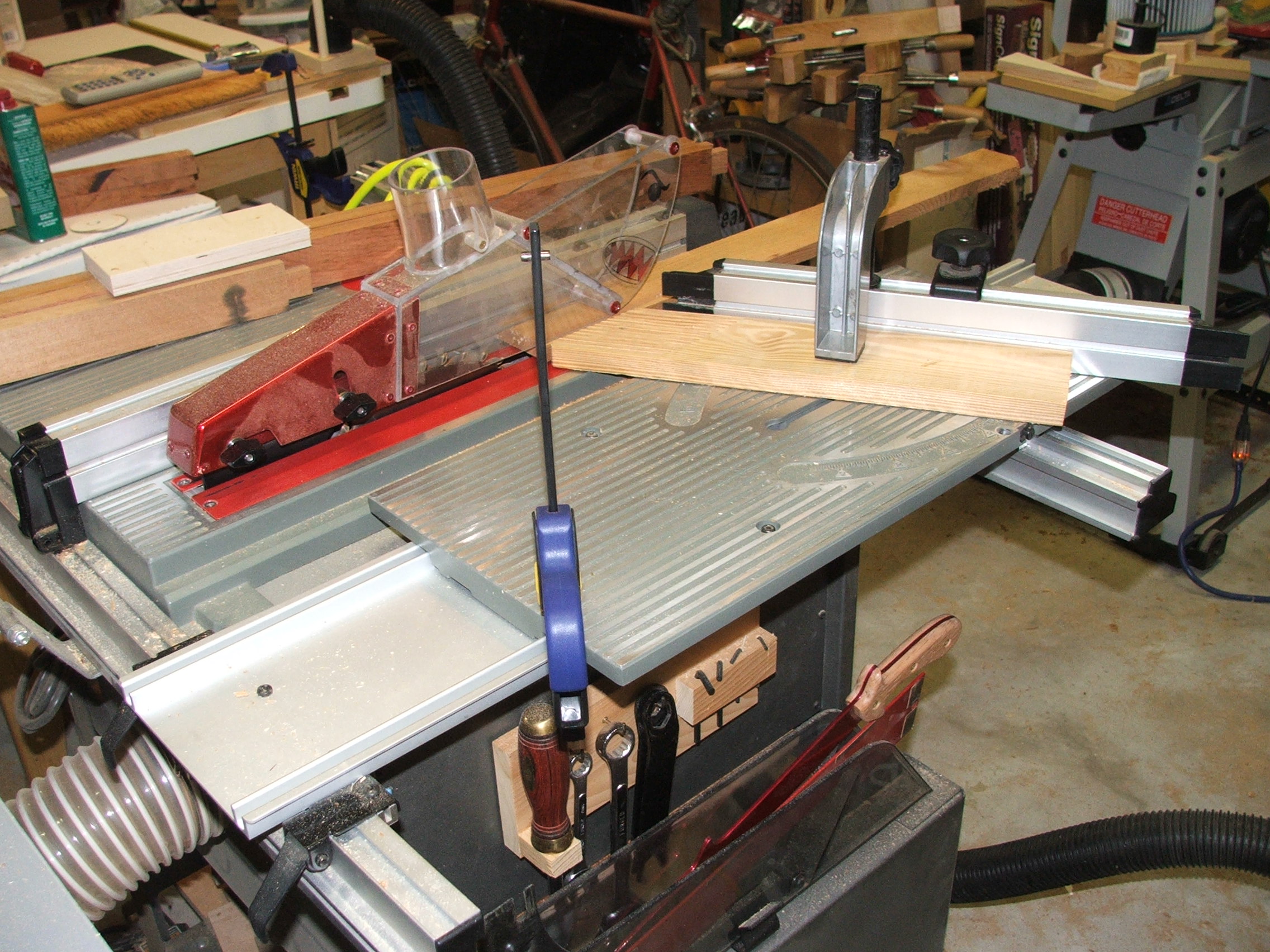

    How does one go about clamping a feather board to the SMT and in front of the blade so that boards are held snug against the fence during ripping?
    • 22098
    here's what I do.
    Lock the SMT at the right position with a clamp to the fixed base. the Featherboard should be entirely before the blade leading edge.
    Lock the featherboard to the SMT by adjusting the angle (mines cut to 30°) of the miter fence. I used the Ryobi miter clamp but you can also clamp right to the moter fence or even put a vertical on the leading edge of the featherboard and use the slot in the front of the miter fence.

          Old to you, new to me! Thank you very much for the large photo showing me just what to do.
