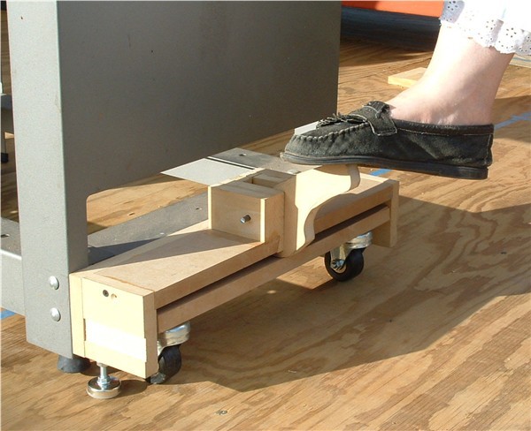

      I came up with a castor bracket based on the Wood magazine mobile base that could be bolted to my BT3. I never have mounted the finished product but the MDF prototype worked as I hoped.
      The prototype:
Name:	Caster Lift 3.jpg

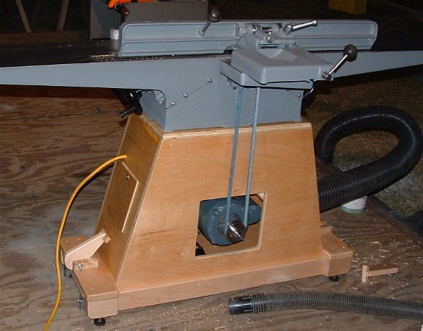

      The lift incorperated into the jointer base:
Name:	Motor and Belt.jpg
      It shouldn't be too hard to modify the back of the lift to match the angle for the splayed leg base on a BT3100.
