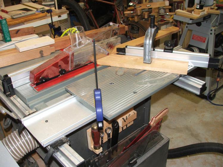

      3. I'll attached a pic of my featherboard setup. I rotate the miter fence clamp a featherboard to it at the correct angle (30°) and use a clamp to lock the SMT in the right position (FB just ahead of the blade). The board attached to the miter fence I feathered the angled edge against the piece being ripped.
