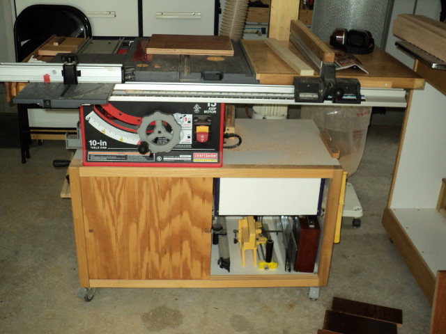

    I am fishing for ideas here folks. I need to see some custom rolling cabs under a BT3K. Mostly looking for ideas, not to copy, but integrate the best ideas I see... Like many of you, I need to maximize storage, and under the saw seems like the perfect place to start..

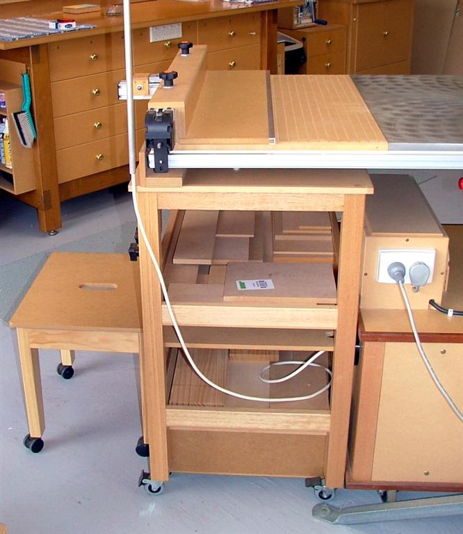

    I had an "identical" base on my BT3000 - I built this one when I went to the dark side
    The right hand unit (mobile), does not provide support - just more storage under the "right wing".

        I am humbled to follow Rod's masterpiece of fine wood(MDF)working with my offering. It's just a box of 3/4" melamine board butt joined with glue and screws. I dado-ed just through the melamine to give the glue bite, then pre-drilled for 2 1/2" deck screws. The back is also 3/4" melamine inset into the top, bottom and sides. It's solid enough that it does not follow the hilly contours of my shop floor, meaning there's often one wheel off the deck. The casters are 2 way locking. The drawer and the area under it holds TS related stuff. The rest of the cabinet is for jig, Circular and reciprocating saws and their associated items. The doors are slide-by so as to not need swing room or hinges. I built it for my BT and sized it to best make use of scraps from the HD cull bin. Total cost was less than $46.00 and $32.00 was for the casters.

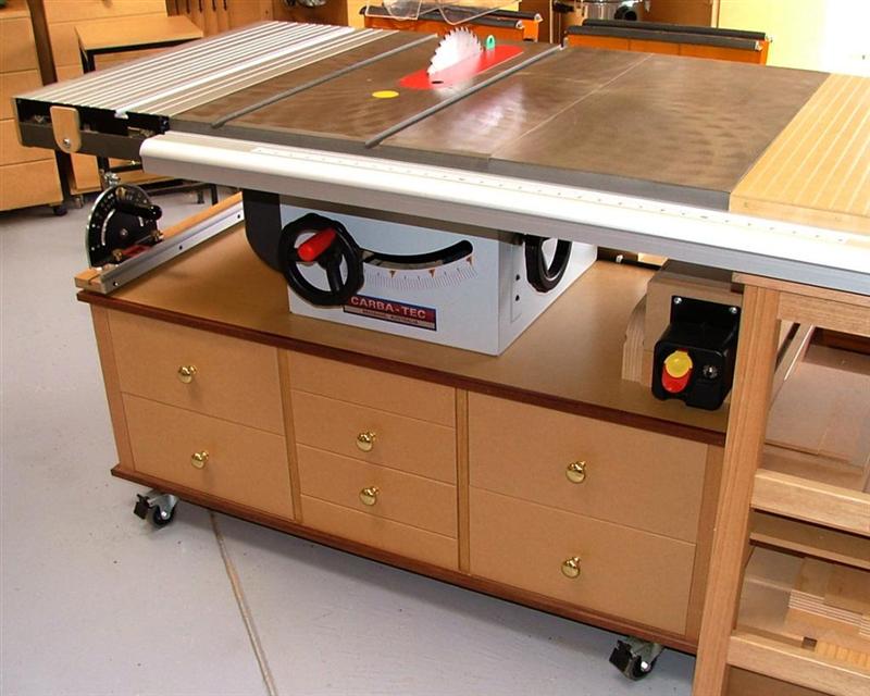

            Mine is real close to Sam's Maroon and Maple in design. Sadly many of the pics are hosted on LOML's gallery on Stan's server and I can never seem to remember the URL for that. An older page can be found here.

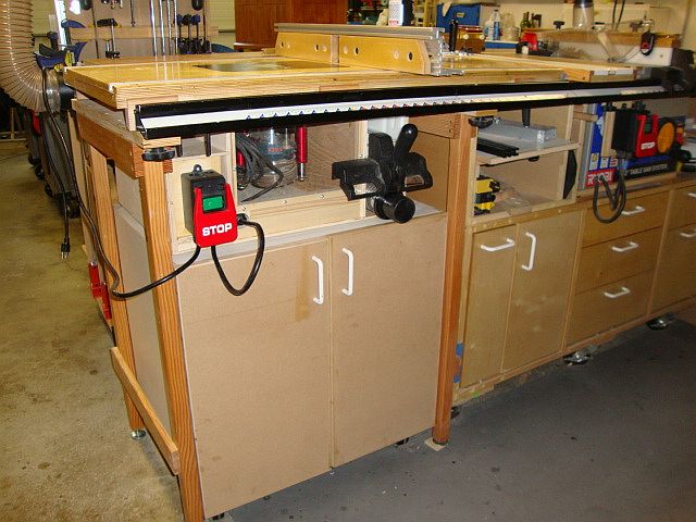

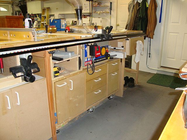

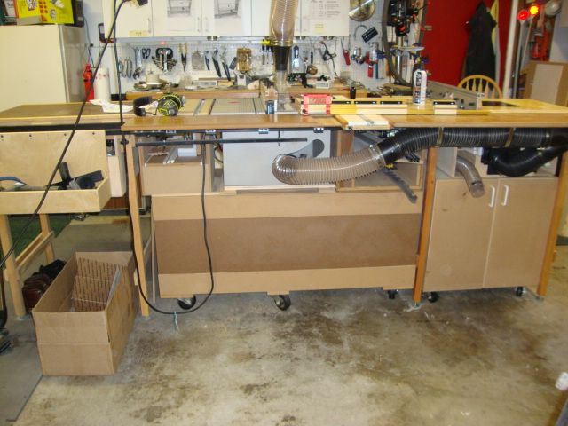

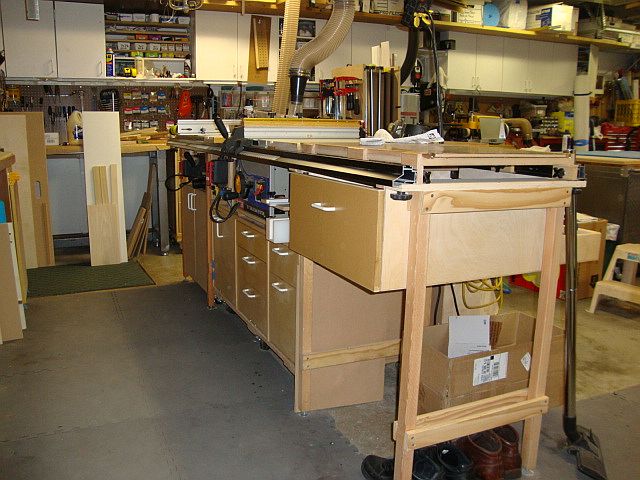

              Here are a few pictures of the set-up that has 'evolved' over several years. Virtually all of the ideas incorporated here have come from this forum in one way or another. I am fortunate in having the full width of a garage to work in.
              Essentially, the system consists of the BT3100 mounted on a center mobile base with a router (and lift) table extension to the left and an extension table to the right (as you face the front of the Bt3100). The back view shows the dust collection system. The three sections are fairly easy to see in the photos and can be added one at a time, or even not at all. Its designed to come apart into three sections, roughly as described here.
              The only aspect that might require some patience is the acquisition of the rails for the extensions (this forum is probably the best place to find them). But although I wanted rails the full length, they are not necessary.

                  This isn't as mobile as I would like at times, but then, I don't have to move it much, either.

                          When I got my BT3000 it was on a wooded table with 4 2x2 legs. I kept cutting the legs off until I had the saw at what I thought was a good height. Then I built a stand to see if I really liked that height. It's made of 3/4 white ply from Home Depot with a torsion box at the base a full 3/4 back and the face frame is just more 3/4 ply. I haven't gotten to making doors or even organizing the insides beyond the shelf under the router. On the right is a switched and a non switched outlet for the router and saw. Now that I have an automatic vac switch I need to re-do that. Perched off to the right is the fence for the router.
                          Here is the cart, 34.5" high
                          Here is a detail of the casters, 4 Grizzly 3" 2 way locking swivel casters.
                          It's really just a simple box on wheels but for now it does the job.
                          over here on the left side
