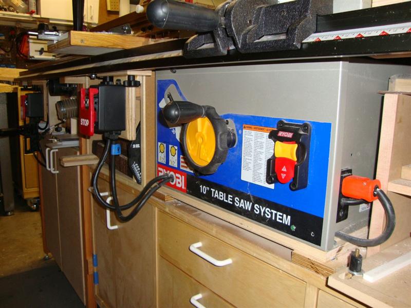

                      I should have included a photo. Sorry, but here is one.
                      I elected to feed the wires through the front panel because ther is very little room on the saw's left side. The switch is mounted on 3/4 BB ply and held on the rail with standard T-nuts.
                      The orange plug is wired into the added switch and becomes 'live' only when plugged in and the Ryobi switch is in the 'On' position. The original Ryobi plug (male) is plugged into the plug (female) wired to the other cord coming from the added switch.
                      This arrangement leaves all the original switches and safety plugs functional.

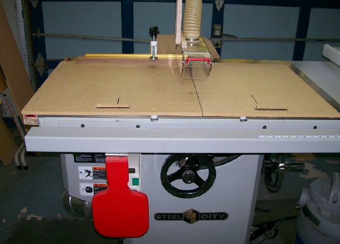

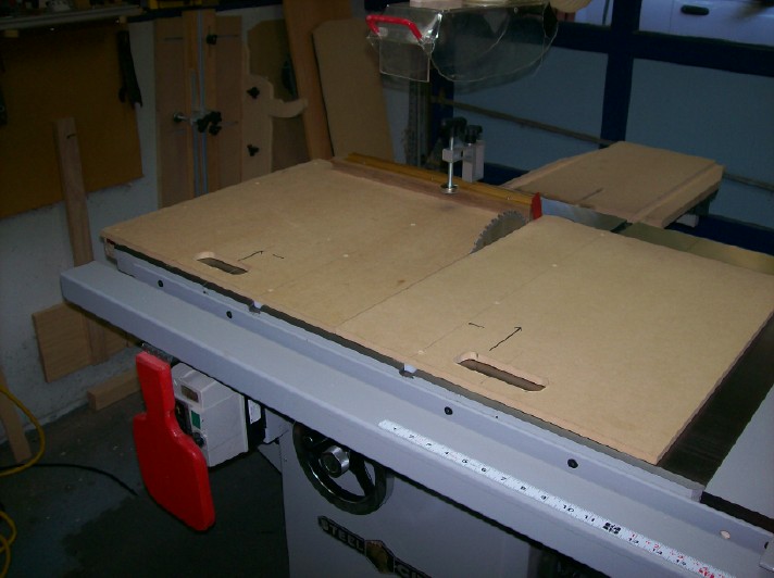

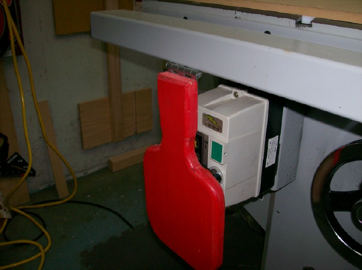

                          This is not a BT saw.. but with a door hinge.. a few holes drilled under the rail... and a piece of scrap ply invested, both hands can remain on top without ever having to use one to turn the saw off. The first week I did bump the saw off on occasion but... I prevent that now by not leaning deep into the table which is a good off-shoot that evolved from this.
                          BTW.. not to difficult to find the o paddle with your knee on this set-up.
