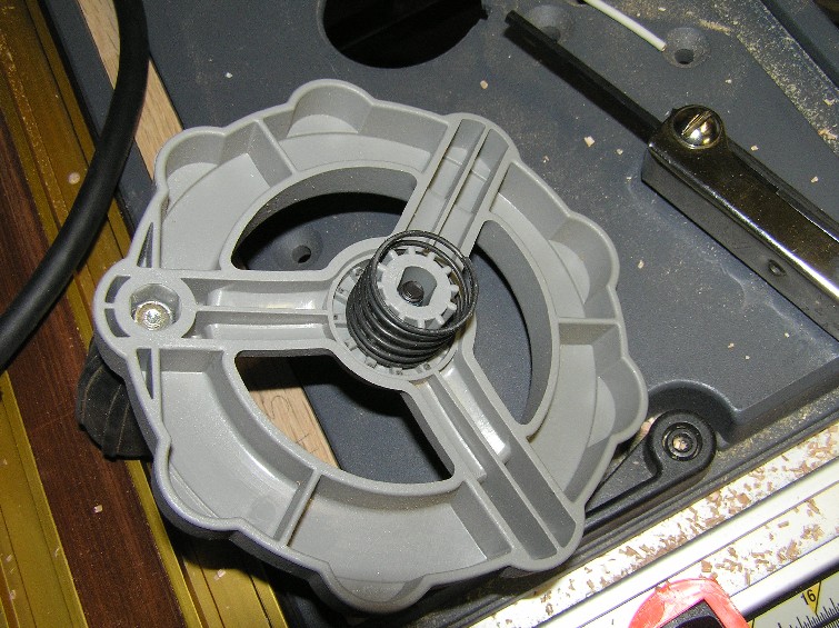

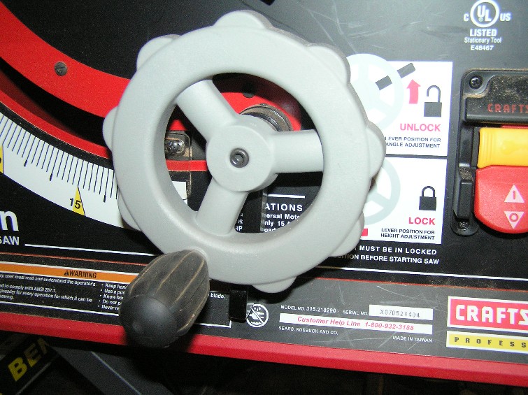

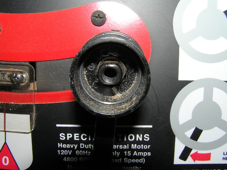

            Took these pictures of the 21829 handwheel and mount tonight - hope they are helpful.

              Bill can you measure the dia of the round part of the shaft and also the distance across the flats on the shaft in your last pic? I hope you have some calipers...
              And, is that a 1/4-20 allen head screw ithat holds the wheel on?
                Loring,
                The bolt is an allen-head, appears to be 1/4-20. The shaft is ~0.43in diameter, and ~0.33in across the flat. I didn't measure the bolt length, but I think it was around an inch.
                  • 22060
                  very, very odd sizes... not even 1/16ths or 1/32nds even, and not metric. What are they thinking?
                    If they were shooting for a 7/16in or 11mm diameter on the shaft, the tolerance was close, but a little bit off. Across the flats, ~0.33in is fairly close to 5/16, but again, slightly out of tolerance. But for fitting a plastic handwheel, using 7/16 and 5/16 is probably "close enough".
