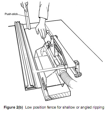

                Personally, I think that a bevel rip is not more dangerous than a "normal" 90° ripping.
                In the EU they teach in schools to rip bevels with the blade tilted toward the fence but a Riving knife and a "Short/Low fence" are more than recommendation...
                If you don't use a riving knife (splitter is ok but only if your blade is at "full height") or not using the short fence - don't even try this method ((I would recommend not to try even normal ripping without RK and short fence)....
                As for Featherboard, it helps me to control long workpieces so they are pressed to the fence.
                Saying that, I think that a bevel rip with the blade tilted "out of the fence" will give smoother cut on the "visible side" of the bevel and, if you bevel cut both sides, the first bevel will not enter below the rip fence (the apex is at the upper side)...
                So, here is the way thart the HSE (UK equivalent to the USA OSHA) is showing to make bevel cuts...
Name:	Rip fence low bevel.jpg

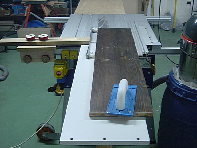

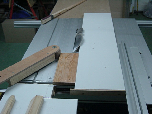

                And here is how I do it...

                  I love that roller jig in the last photo. Where did you get the wheel/arm part?
                  • niki
                    • 566
                    • Poland
                    • EB PK255
                    #24
                    I posted it here
                    http://www.bt3central.com/showthread.php?t=25123
                    As for the parts, well, I live in Poland so I cannot advise...
                    Regards
                    niki
