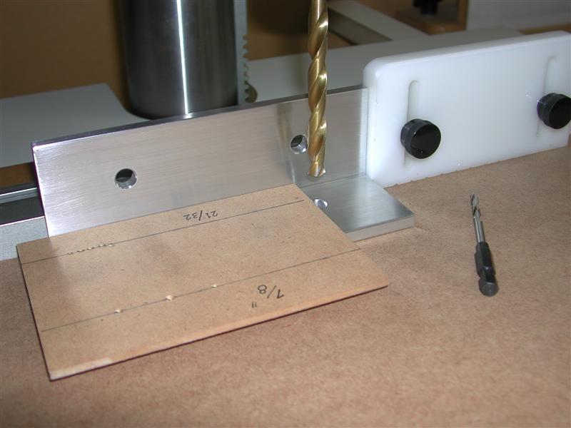

                    From my archive (August 2004)...
                    WT Connectors – BT3000
                    Well, these worked out fine. Guys, these are not difficult make – all you need is a template, Drill press, 1/8” and 5/16” drill bits. (DP speed 2,200 RPM). If you are uncomfortable working with metal (I am), remember that Aluminum is light and “soft”, not like steel, heavy and hard.
                    Two pieces of aluminum angle – 2” x 2” (external), ¼” thick, 6” long.
                    The 5/16” holes are 1-1/8” from each end and located (measured inside the angle):
                    Front: 7/8” in for underneath, 21/32” for the vertical pair
                    Rear: 7/8” in for all holes
                    To locate the hole, I used a template (see pic). It’s fairly easy to set up – just make sure you do it carefully. Chuck a 1/8” bit and use the template to locate where to drill. Remove the template before you start drilling. To start, touch gently with the bit and it will “dimple” the aluminum enough to prevent wandering. Don’t hurry. You can drill 6 of the 8 holes (7/8” in) without altering the setup. After the 1/8” holes are drilled, swap to the 5/16” bit and complete the holes – if you’re gentle, and hold the aluminum firmly, there is very little “chatter” as you begin the hole. I found I did not need to use clamps.
                    Countersink the holes slightly, and cleanup with steel wool.

                      just out of curiousity I looked up what it would take to make a deluxe connector set:
                      8 bolts per rail (2 each side, bottom, and inside ) 1/4-20 x 1/2", plus lock washer 16 total .07+.03 ea = 1.60
                      12 Lg, and 4 ex lg T-nuts from t-nuts.com $19 + 4.50 shipping = 23.50
                      and 2 ft. of 1.5x1.5 x 1/8" aluminum angle = $6.32+$11 shipping = 17.32
                      Total $43 plus cutting and drilling. Makes Komatoast prices look much better.
                      I suppose that by using angles instead of strips you get more torsional strength so you could do like Rod K and only use a total of 8 bolts and save some T-nuts and bolts.
                      BTW ROD- what did you screw the bolts into? The rail? Ryobi T-nuts?
                      Now, whats the absolutely cheapest way to attach rails?
                      Gte some "Mending plates" by stanley, 3/4" wide and 4" or 5" long. About $3 each.
                      These will lay in the t-track (whose opening is at least .80"). Drill holes in the plates, 4 per plate (they already have 2 sometimes 4). Drill matching, 1/4-20 tapped holes in the bottom and insides of the rails where they won't show. Put 1/4-20 bolts through the mending plates into the rails.
                      Probably about $15 or less in parts, all available at Lowes or HD if you buy them all new.
