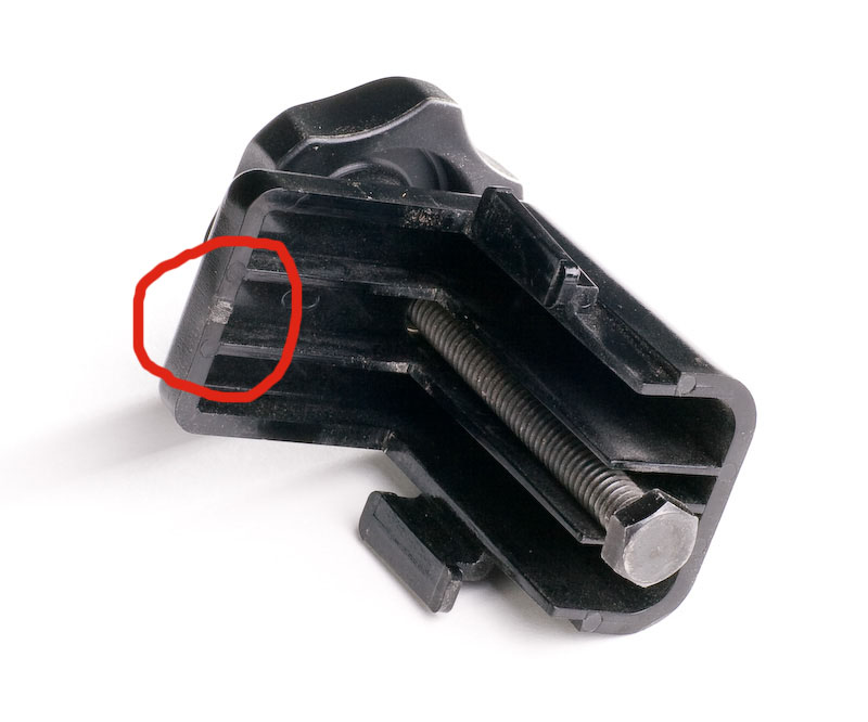

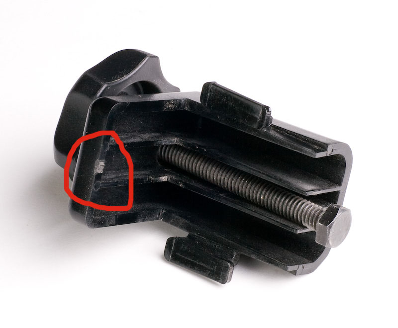

I find that even if I really tighten the miter fence clamp knob, the miter fence still moves a little (rotates by 1/2 a degree or so) with moderate force applied to the end of the fence closer to the blade. This makes it difficult to get accurate crosscuts because the fence moves enough during the cut to rob me of any accuracy. Initiallly I though the source of the problem was simply insufficient tightening of the fence clamp knob, but that's not it because even when it's as tight as I can manage the fence can still rotate somewhat. Is there a solution for this? Maybe I need to change my technique also?
