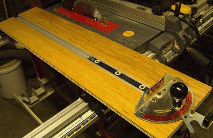

                      Originally posted by docrowan
                      I like the adjustability of being able to pop the thing on and off quickly. But $60 for just the accessory table from Sears seems pricey to me. I'm also considering purchasing the 21829 recently posted here and being done with the whole thing, but there are some logistics issues to work out.
                      I mentioned this elsewhere, but the accessory tables for the 21829 can not be adjusted to parallel with the blade. It is useful for featherboards but not a whole lot else.
                      I got around it by using the base of an old broken SMT and some plywood and flooring scraps to make a miter table that can be adjusted parallel to the blade.
                      The front overhang is also sometimes very handy to help stabilize larger boards.

                        #26
                        That's looks like what I'm wanting. Easy on, easy off. Some of the plans I've seen for miter slot attachments look more like permanent mounts.
                        - Chris.
                          #27
                          If they're attached to the saw frame rather than the rails being permanant is ok, you can move the rails without having to undo the miter table.
                          Doug's solution is pretty slick too. The same idea could be executed without a smt base, just use the same premise for alignment that the smt uses.
