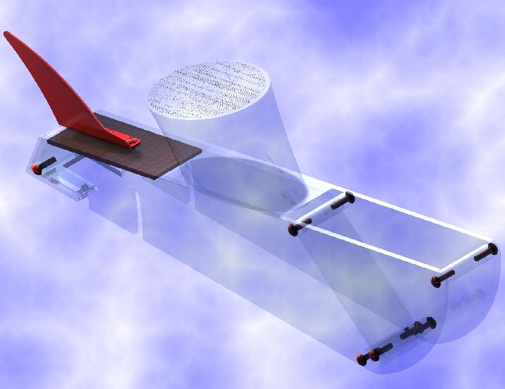

Many guys do use the blast gate with the 4" port, but it's location isn't always convenient, especially if you just need to close it some for one particular cut. The design I am working on would not add much weight at all. All of this weight would also be right over the clamp where the guard is the most rigid.
I should be able to show an initial drawing of it this evening or tomorrow.
Basically it will be a shark tail fin similar to the tail hook with a bend. It will get 2 small screws and lock nuts and attach inside to a clear lexan plate. It won't fully close off the port, but it will shut about half way, which should be just enough to reduce suction so it doesn't pick up small parts.
