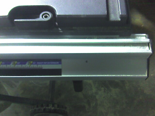

        Especially because that's about the amount the rails usually have to be scootched to the right so they don't hit the floor when the cart folds up. The slightly shorter ones would work much better with the folding cart, IMO.
        One indication that the length is a real orphan strand of the design: the measuring scale tape stops five inches short of the right end of the rail--almost undoubtedly the same as on the BT3100.

                    I guess my Q is relative to the scale. Do they have more aluminum to the right of the scale (and does the scale go above 24"), or to the left?
                    They have about five and a half inches of plain aluminum to the right of the scale. What I meant was that the scale itself it probably the one from the BT3100, because the scale tape just stops.
                    • dkerfoot
                      • 1094
                      • Holland, Michigan
                      Here is a picture of what Gwyneth is describing:

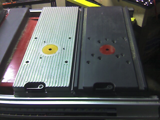

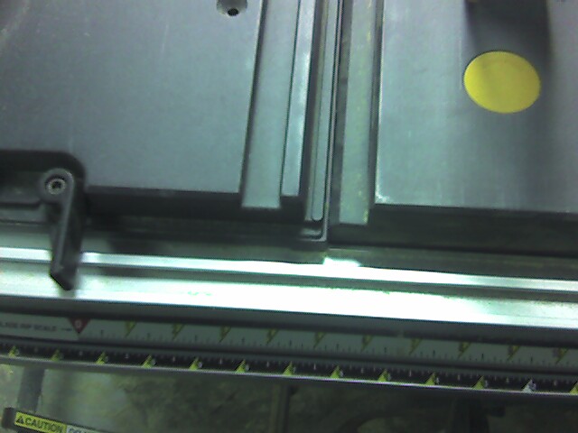

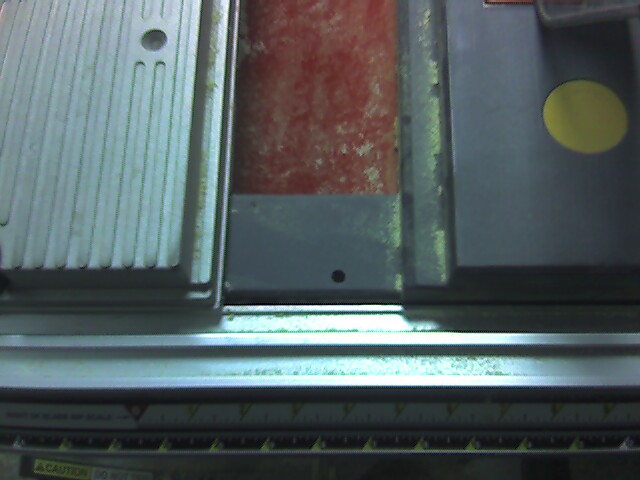

                        Is it possible to snug the accessory table all the way up on the left side of the saw on the BT3s? I can't do it with the accessory table from the BT3000 because of the mounts for the optional left miter table, but it is no problem with the one from the 21829.
                        The difference in height does indeed seem to be the grooves. This hasn't been a problem since I use the extra table exclusively for mounting a router. But, now I am wondering if the two dual miter tables that are being delivered today will ride too high... I'll post an update when I find out.
                        Because of the built-in miter slots, the accessory table on the 21829 is considerably wider. In practice, this makes it much easier to slide up and down the rails without binding.
                          The dual miter tables arrived today and they will work fine. In fact, it looks like I'll need to use all four supplied shims (2 per side) and if there were more, I'd consider adding a 3rd one per side.
