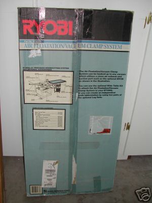

floatation table
  • kramer katt
    • 375
    • SO CAL, USA
    • BT3100 and Craftsman 100
    floatation table
    one of these is currently up for bid at you know where
    there was some discussions here about is minor useflulness sometime ago
    Does anyone have more recent experience?
    btw
    amazing to think a bt3000 accessory is still available new in box

      I only saw one in the early 90's at Builder's Square (anyone remember them?).
      I recall reading comments that some people liked them and some people thought the top was kind of flimsy.
      You don't see many of them around but they can still be bought for a pretty penny from some of the distributors.
      One issue was the vac - Ryobi recommende you use their vac (no longer sold) which had an external fan cooled motor. Which meant you can use it "dead-ended" for a long period of time without overheating the motor.
      Dead-ended is what you get when you have an item blocking all the holes in the vacuum top. which is more likely than you thin because there's some gate valve on the bottom that allows you to block off large parts of the top so you don't lose suction when working with smaller items.
        I remember Builders Square, all to well. It was one of three chains that locally went out of business. Now they and Montgomery Wards are back, only in an online fashion.
        The closest thing to the Ryobi vac, that I am aware of, is the Fein Vac's, but they are $$$. The flimsy part is what stopped me from buying one online several months ago.
          i guess the flimsy part is relative. It's probably 1/4" material and only partially supported within. it will hold a 4x8 or 2x4 sheet of ply or other board all day with the weight of them spread out over the top with or w/o the air float running.
          But you can't use the large top for a workbench as inviting as it might look.

              I have one
              and have used it as a extension table. I do not use it for what its intended use. It never really worked well for me. However the extended table is great. JerryMak2

                I thought the reference to "bid" gave a clue but if interested look for it
                on that site otherwise known as "flea-bay" or ebay
                search "ryobi" and "table saw"
                he also has the rail extensions and leg kit up separately
                these might be useful on their own without the vacuum table

                    I got one from a saw I bought off ebay.
                    I took it all apart and kept all the hardware. The table had sagged a little due to being in a damp basement for a few years.
                    Maybe...........
