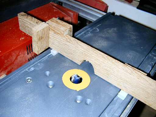

    Hylton suggests in passing that if you insist on doing laps in the middle on the router table, one way is 'the dado sled". I was looking at those plans, which involved a sheet of thin material with a slot in the middle for the bit, ledges that fit on either side of the table, a big fence in back, and an end butt piece "to prevent the piece kicking to the right", which then has spacers added to control the width (length?) of the lap.
    As I was trying to figure out which thin material to use it dawned on me that with two slots on the BT/Craftsman's accesory table, putting the ledges on was completely unnecessary. Then I decided the sheet was superfluous, as well, its function being to connect the ledges.

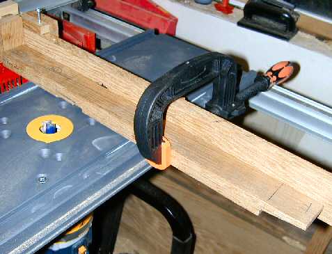

    This left the fence. I cut two little pieces of UHMW (cutting board) and bandsawed a crude arch in a long piece of oak for the bit to pass through. The UHMW runners are attached to the fence (and to small stabilizer blocks of oak on the back of the fence).
    The thing at the far end of the first picture was my attempt to replicate the end butt/block. But its grip on the fence wasn't firm enough (as long as it was adjustable) and I was having second thoughts about loose spacers traveling happily along with the workpiece and fence.
    I decided I'd have to made a sturdy L-shaped thing and figure some complex way to attach it. Meanwhile, power tool curfew was about to hit and I wanted to test the glider concept to see if it was worth it.
    So I grabbed a strange, large plastic C clamp (two of them came with a collection of clothespin clamps) and used it to attach a workpiece to the glider.
    What a happy accident! It secures the workpiece much better than Hylton's design (which involves holding in place against the right butt piece) and serves as a handle, too. My hands do not touch the workpiece in its travel across the table.
    It worked so well that I was able to improve or start eight separate laps in the next fifteen minutes. The thing that was supposed to be the heavy-duty right hand butt piece is fine as a stop block.
    Excuse the funky light--all the glass on the back porch sends strange reflections. The first picture shows the glider by itself; the second shows the strange clamp/glide handle holding a workpiece (if the fence looks a lot like the workpiece, it's because I've got a lot of recyclable oak.)
    Fantastic solution to your problem. Next time I would probably let the router bit cut the slot in the rear fence. That way it will match the profile of the bit exactly, and prevent tearout as the bit exits your workpiece and enters the fence.

        The reason that I didn't 'sacrifice' or use the router bit to cut the opening was exactly the same one that prompted me to make a jig: even with the bit barely sticking up, hitting thick white oak on the cross-grain is a hard reaction to control.
        I discovered that trying to make the first workpiece without the glider.
        If I were taller, had longer arms, and especially a few years more router table experience it might be different.
        Without that experience, it's helpful for me to know when the bit has gone through the workpiece and lets me perfect one continuous motion across the bit.
        Where I got really lucky was the clamp/handle. A 6" metal C-clamp would be way too heavy to use like that, and the plastic one has a quick ratchet button that makes getting it on there almost instant. A purpose-built handle couldn't be better--my left hand holds the C-part, and my right hand the actual clamp handle.
        Not only is that a good way to make sure neither hand goes anywhere near that bit, with the workpiece clamped on the ergonomics are similar to the SMT's--predictable travel independent from the worker's manual judgement or skill (i.e., lack thereof).

            The compromise solution that solves both problems: build the glider fence as you have it, and then back up the workpiece with a sacrificial piece of softwood or MDF (i.e., between the fence and the back of the workpiece).
