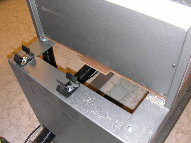

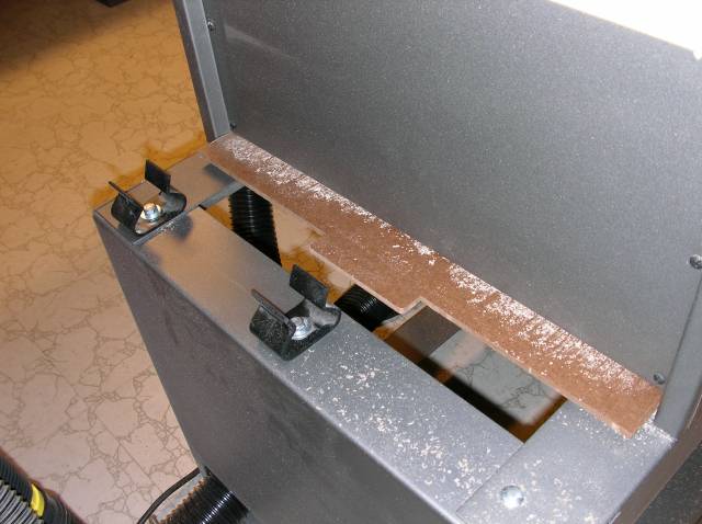

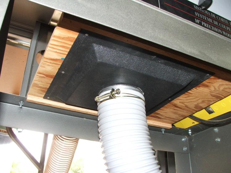

    I have a belly pan and 4" outlet on the bottom and it keep the inside quite clean. Also I use a 4" to the rear port with a reducer at the saw.
    The inside picture is after running the saw. The little bit of dust you can see in that interior picture is from before I installed the belly pan.
    I still get some dust thrown from the top. One day maybe i'll do something about attaching another hose to my shark guard.
    P.S. I think the recess of the pan takes care of the interference with 45° tilt that BillSTR was talking about a couple of posts down.

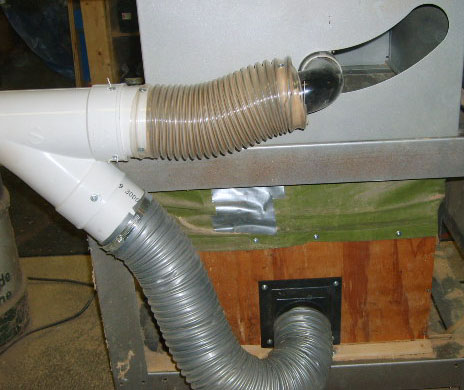

                          I use 4" flex hose to go to the 2 1/2" dust outlet and that allows it to move for the bevel cuts. Then a piece of 4" down to the bottom collector box

                          The collector box has a bottom and is attached to the saw with canvas.

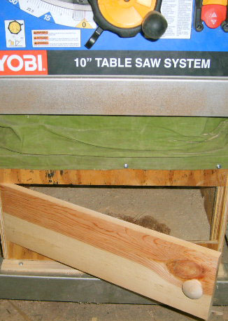

                          The door opens to allow access to the inside but since the dust collection is drawing from the opposite side I have never really needed it although the clearance for the door allows air to be drawn in and across the box to the dust collection port.
