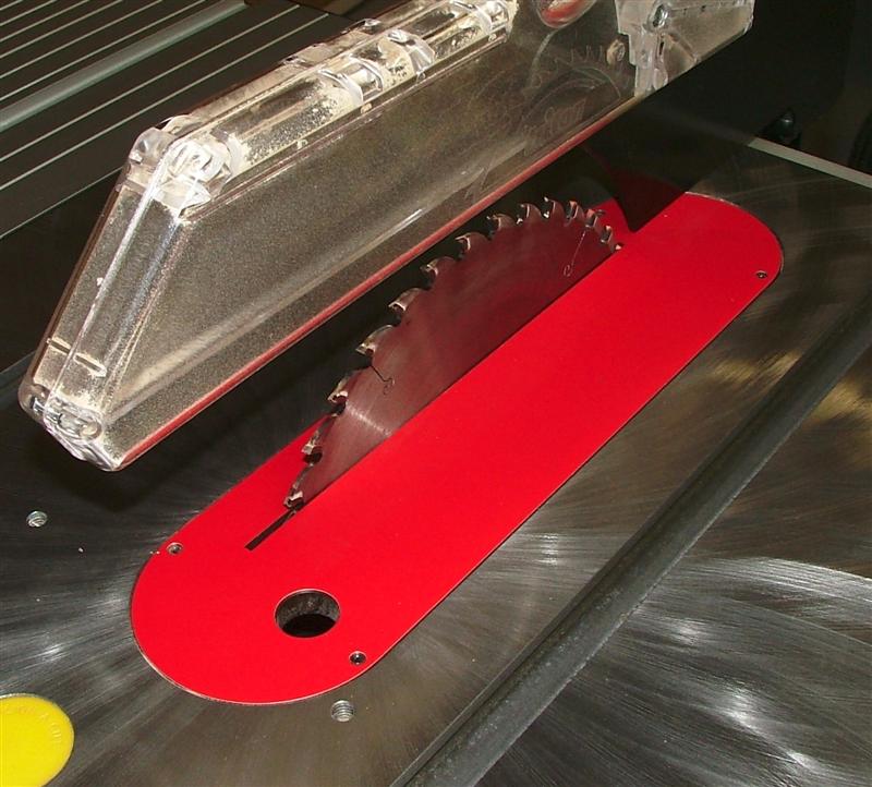

    On my Darkside saw the ZCTP (bought as a "blank") has a center pin at the rear which hooks under the rear edge of the throat plate recess - that's the only thing which holds it down!
    Which makes sense - you don't want the "upcoming" saw teeth at the rear to lift the throat plate. The "downgoing" teeth at the front are not a problem.
    The ZCTP is MUCH thicker/heavier than the BT3x throat plates and is made of phenolic and the saw table recess provides excellent support all around.
    The 3 (of 4), small holes you can see have grub screws for levelling the plate. The large hole is so you can lift it out.

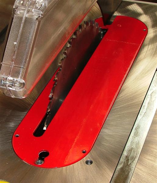

    The OEM (metal) plate DOES have a single screw at the front - still with a center pin at the back.
