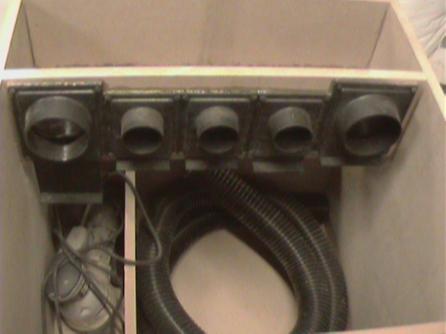

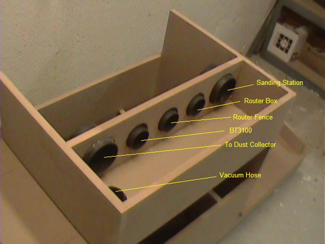

This doesn't mean I want to forgo the convenience of a dust collection "network," though. I had previously created a drop-box/plenum contraption that I dubbed FrankenVac, which worked very well. When I expanded my shop (still tiny), I outgrew the FrankenVac contraption. So I purchased some 3" plastic flex and wye's and built this network.

I use this network on my router down-draft box. Almost nothing escapes it, no need for collection at the fence. And it works equally well for working in the middle of a piece, no just at the edge.

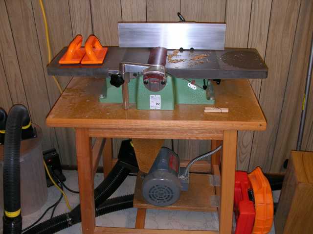

This network also handles my Inca 8-5/8" jointer/planer. Has no problem keeping up with .5mm passes of full-width oak/pine boards (although this does fill the 7-gallon separator FAST). Finally it is used on the BT3K and on a 9" Inca bandsaw.
