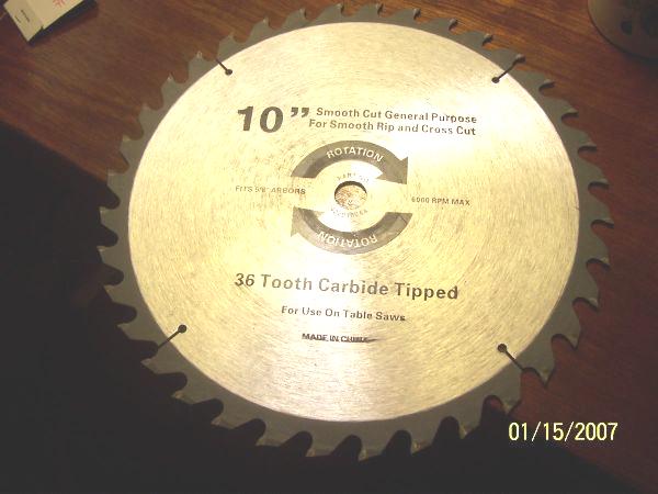

        Just exactly what blade comes from the factory on the 21829?
        how many teeth?
        What's the label say? (e.g. Craftsman, Ryobi, or what???)
        what is the country of origin (printed on the blade, e.g. made in xxx)
        does it have laser cut relief holes?
        Picture would be entertaining.
        Curious, to update the FAQ.

                Not very happy with the blade that was supplied. Will post a pic and specs later today.

                    Pic attached. Note that teeth are there but dark. In case the photo doesn't show, 36 tooth Carbide tipped, Made in China. Also warped so I'm returning to Sears.
                    The warping was the seeming cause of the initial squareness problems. I don't understand why, but as soon as I changed blades, problem disappeared.
                    Cheers,
                    MikeR
                      • 21985
                      I managed to enhance the pic a little.
                      The "manufacturer's part number" is 422010044 (got that off the Sears parts site)
                      rated for 6000 rpm
                      I'll have to check what the old Ryobi p/n was for the 36-T blade.
                      But interestingly, I note these facts:
                      1) on the 22811 Craftsman saw which was a BT3000 basically, the blade was labelled Craftsman
                      2) on the 21829, the blade is different than the Freud OEM blade shipped for many years with the BT3x AND also different from the later China-made blade shipped with late model BT3100s. The Frued-made blade was actually a very nice all-around blade and made very good cuts.
                      3) this blade isn't even as nice as the Chinese blade on the late-model BT3100s, which was made in china but was a very close copy of the Freud, including the bite-limiting fingers on the top trailing edge of the teeth and the laser-cut tension reliefs/expansion (some J-hook and S-shaped reliefs) joints. The blade pictured here is a pretty much featureless run of the mill no-name 36-tooth blade.
                      BTW, a blade can be warped if the arbor nut is overtightened. I generally tighten mine finger snug, then turn the wrench about 1/8-1/4 turn more. Fairly low torque.
