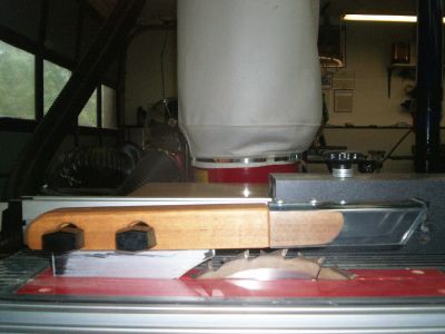

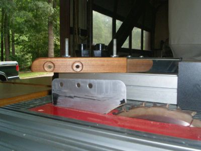

            Good morning Mark...
            Sometimes a picture is worth a thousand words........
            Regards...

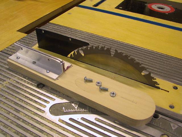

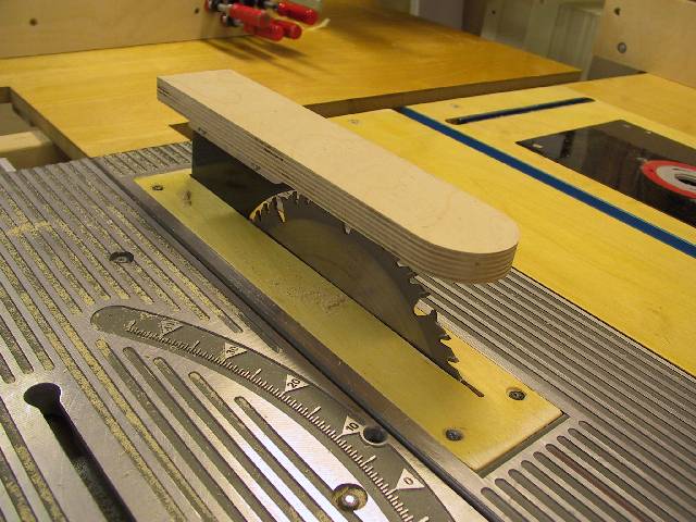

              I took my stock blade guard off pretty early on. Then, I had a few "incidents" that I think could have been prevented by a cut-down riving knife. So I made this:
Name:	Riving Knife Cut-down.JPG
Name:	Riving Knife w-guard.JPG
              Then, ultimately graduated to a Shark Guard for the DC capability.
              But, a cut-down riving knife is probably the best single safety accessory you could add. I would rate it higher than an actual blade guard.
