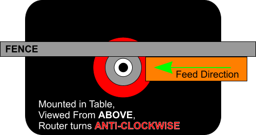

    The work must be fed into the cutter from right to left when inverted in a table, hence with your fence closer to the saw, from back to front.
    If you move the fence to the other side of the cutter, the cutter will still be travelling anti-clockwise, the work still needs to be fed from the right, so this time it would be from front to back. Perhaps this diagram helps?

      For full dado cuts, it does not matter which side the fence is on, but once the fence is used for a rabbet or moulding cut in which the fence is covering part or most of the router bit, then the feed should be against the direction of the turning router bit.
      If standing in front of the saw and the fence is on the right side of the bit which turns in a counter clockwise direction, you would feed front to back.
      If standing in front of the saw and the fence is on the left side of the bit which turns in a counter clockwise direction, you would feed from back to front.
      Situation: The bit turns counterclockwise, half of the bit is hidden by the fence, (the fence is covering most of the bit) you want to ALWAYS feed against the direction of the turning bit. Safe
      IF you feed with the direction of the turn, you would make your router become a slingshot and your wood would be the rock(et). Dangerous

        I might add in Rays Drawing the following caution.
        The Bit can be situated so that it cuts on both sides of the bit as it would as shown.
        Also the bit can be buried partially in the fence (provided there's an opening for it) so that it cuts on one side only and is turning into the wood feed direction.
        The bit should never be placed so that the wood is between the fence and the bit and only one edge of the bit contacts the wood. as someone pointed out this makes the router into a slingshot (or one of those hot wheels launchers).
