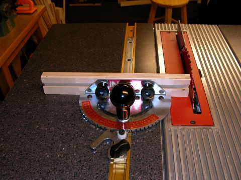

          Another vote for the V27 here. I made my own miter extension and initially used the Rockler (blue) miter track. This is a standard (non-tee) track. I was stunned the first time I tried the V27 in it. In some spots there was slop, binding in others. The tolerances must have been pretty sloppy.
          I was doing google research and I was stunned by the # of people that complained their miter slots on high-end cabinet saws were poorly machined. A common thread seemed to be that Incra products were of very high quality, though. I found Incra made a tee-type miter track so I made a new miter extension table and used the Incra track. The difference between the Incra and Rockler is amazing. Perfectly fluid, no slop, no binding.
          I've since used Incra miter sliders to make a sled, and I'm very happy with the performance of the sliders, too.
          My miter extension attaches using T-bolts from the bottom (using a plywood bracket). I can remove and replace it and align it to .001" in approx. one minute by using the sled as a guide.
          I think I will, however, make a new miter extension that extends beyond the front of the saw by 6" or so. I never really use the fence on that side of the blade anyway.
          Edit: Oh, and I have found that I can use 3/4" plywood to make fences for the V27. I just cut a T-slot in the front AND back. You'd think 3/4" plywood wouldn't be enough for back to back T-slots, but it does work. Still plenty stuff. The one if the picture is a cut-off, but I have another piece that is 30" long and is easy to exchange w/ the shortie.
