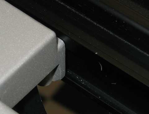

    Here are pictures for my glorious 'addition' to my BT3. The pictures show the view of the front rail from the back, at the left rail attachment point.
    You can see the slightly curved mark on the rail. On black rail, it is highly visible. This is a mark for right rips. For left rips, there is another mark elsewhere on the fence.
    Here, the mark is aligned to the edge of mount point. The resulting alignment precision is under 1/64" - higher than the rail tape resolution.

            Mind you, I rarely use the scale on the rail. I prefer to set things up to be relative to each other (i.e. rip a piece as wide as another one is long, or cut off to fit between two other parts). However, now and then, there is a need to cut a piece that does not need to 'fit', but needs to be certain size. In such cases, if I had to move the rail for capacity, it takes only a couple seconds to zero the rail back on the mark.
