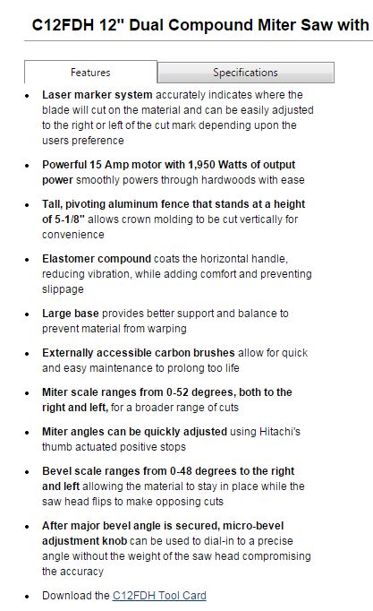

                            • 22023
                            Hitachi C12FHD 12" Dual Compound miter saw.
                            I may have added to the confusion by calling it a dual Bevel saw.

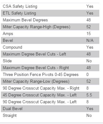

                            the lowes ad is unspecific as to the name and the spec categories are a bit confusing with multiple lines referring to the bevel (compound - yes, bevel-yes, bevel right-48, bevel left-48, dual bevel-yes but they are all correct):

                            The Hitachi web page does in fact call it a Dual Compound miter saw
