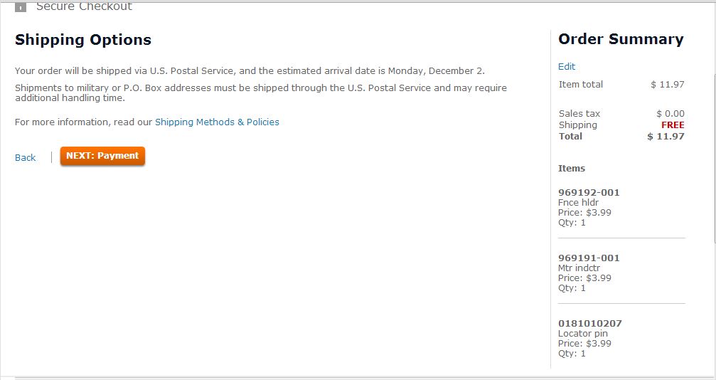

                I just looked at the sears website. All the parts are $3.99 each (3,5,6) I just hit the checkout options and USPS shipping said free $0.00 to Texas. I'd say thats the way to go, you'd be all set.

                  I am missing several of the same parts, and noticed the whole miter fence assembly is available for $16.06, kit 35 in the drawing. I'm not getting the free shipping option on either that kit or the individual parts, thought, so it's another $10 or so for shipping and tax, $26.55 total for me.
                  Did you have to do anything special to get the free shipping option?
                    Not certain if this will work or not, but here goes --
                    I was watching the news last week. They said if you are not offered free shipping wherever you shop, call them on the phone, and ask for free shipping. We just bought some wallpaper, and the local store wanted around $25.00 shipping. I went online to get the online number for ordering. I asked for free shipping, and there was no problem getting it. It's sure worth a try.
                      That's definately a deal, If nothing else you can string the old and new fence pieces to make an extra long fence. Its also the same extrusion as the rip fence, you can make a stop or other jig with the ectra fence piece.
                      As for the shipping, I just entered my address and billing address, when i clicked on shipping options it said you'll get USPS shipping, and listed the price as free. Maybe because its small parts that fit is a small padded envelope that can be sent first class for under a buck, they already jacked up all the prices - note that no part in their catalog is less than $3.99 (used to be $2.16 last time I looked). So they are making plenty of money.
                      Another thing I recommend with Sears Parts: For the more expensive parts (e.g. more than $3.99), try all models of the saw, including Ryobi BT3100, BT3000, 315218290, 315228110 because I have found 2:1 different prices on what are the exact same interchangeable pieces for different models. Specifically belts and blade wrenches. BTW Tom, if you don't have the original blade wrenches which often get lost when a saw is sold, get one (the smaller) because it has the arbor lock to keep the arbor from turning when you want to change blades. Was as low as $5 and handy.
                        http://www.searspartsdirect.com/part...&prst=&shdMod=
                        Ok, I had to cough up $8.99 for shipping, and also needed an upper and lower slide, so that should fix me up well enough.
