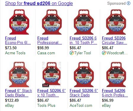

                  Here's some other sellers and prices:
                  (note how eBay is often overpriced!)
