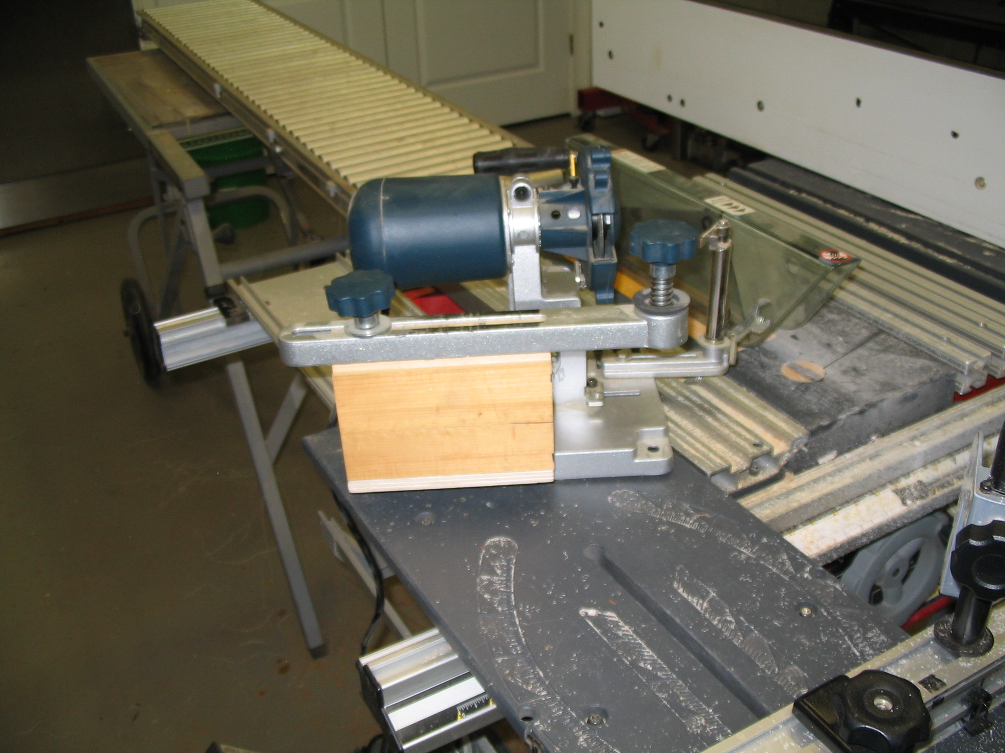

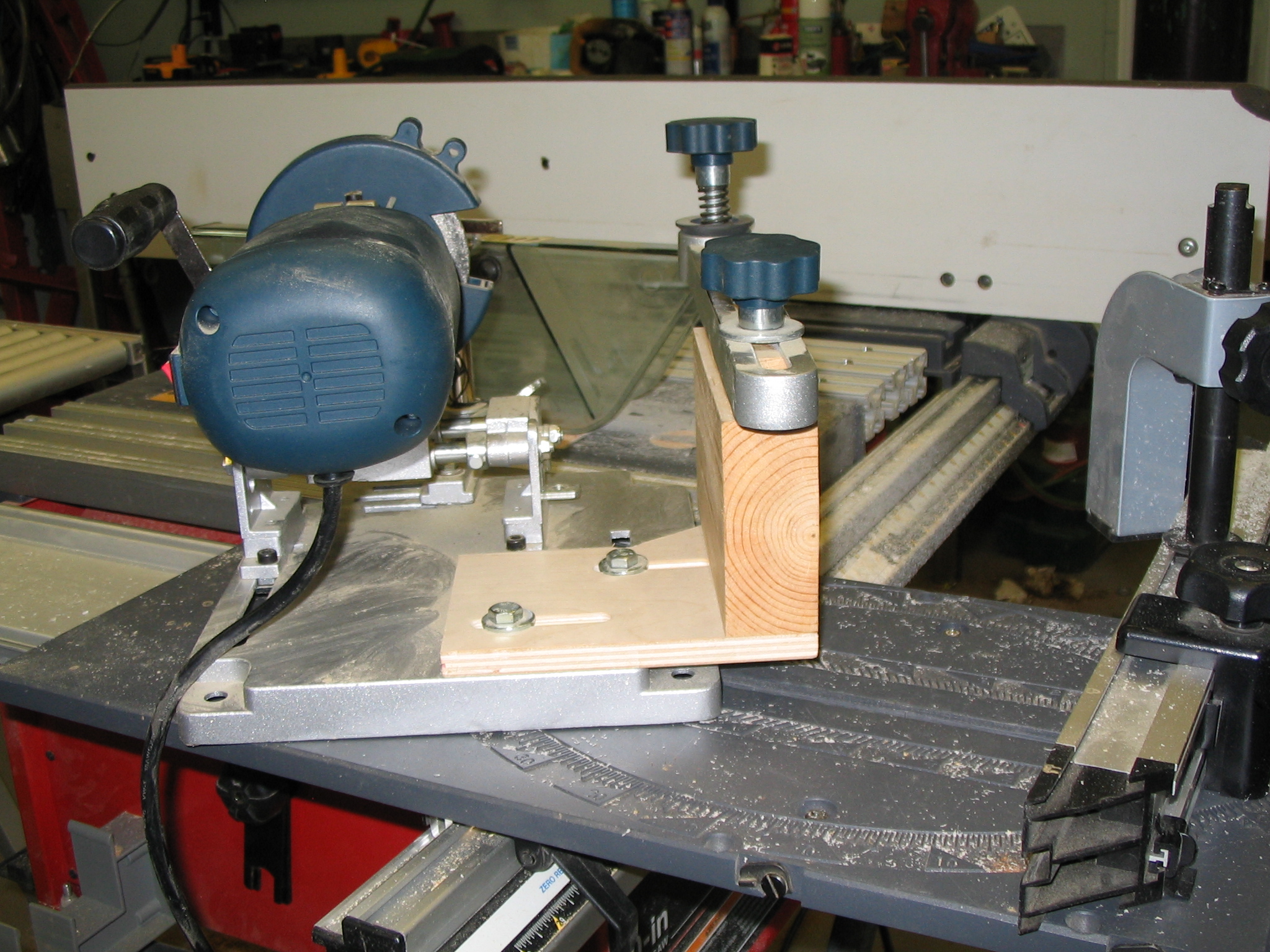

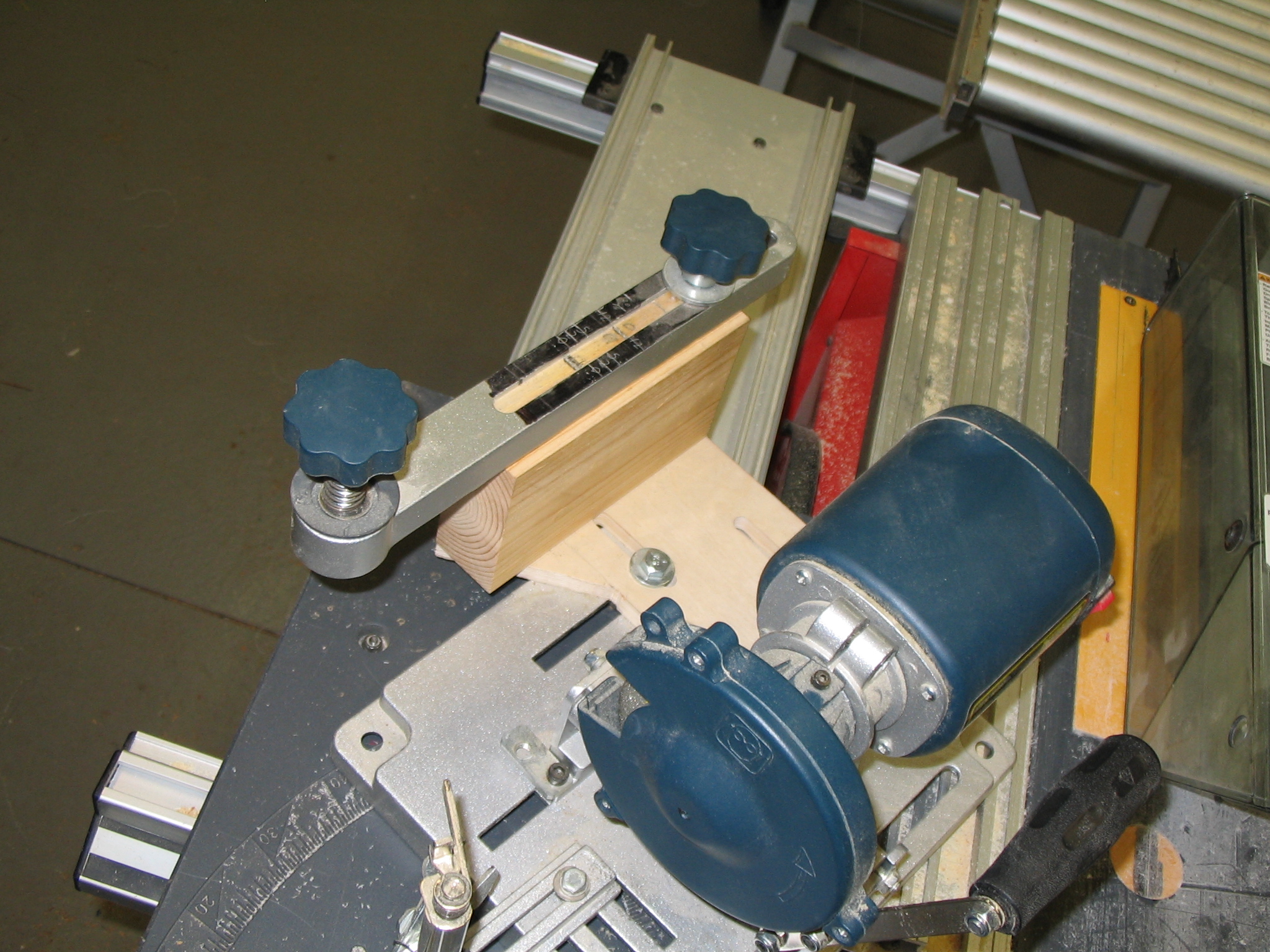

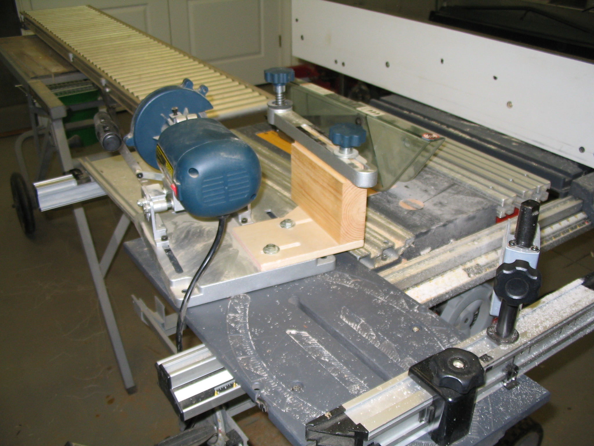

        Capncarl, would you please describe, and if possible post a picture of, your modified blade holder? You mentioned this in your response to lchien's post regarding sharpening costs, and it interested me then too.
          • 3791
          These are photos of the modified blade holder for my HF blade sharpener. It is just a wood angle bracket that the adustable bracket fits over. I junked the factory provided adjustable bracket and post. The sharpener motor/wheel is adjustable for heigth, so the new holder height is not an issue. This makes the blade much more stable for sharpening. I don't really like the factory provided indexing feature for each tooth, but it works but if I get around to changing the index I will put it on my blade holder.
