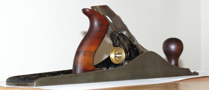

                            Stanley's like this one were pretty poor:
                            Here's a Stanley Handyman that's decent:
                            Here's a Stanley Defiance that's better:
                            Here's a Stanley Bailey that's very good and a comparable Record and Millers Falls plane (as examples of good ones):
                            Here's a Groz:
                            • Cochese
                              • Jun 2010
                              • 1988
                              This isn't meant to be snarky at all, but how can you tell what's good and what's not just by looking at them?
                              I mean, besides obvious defects like the sole being twisted or missing pieces or what not. The ones you posted, I can't tell any appreciable differences that would have me pick one over the other.
