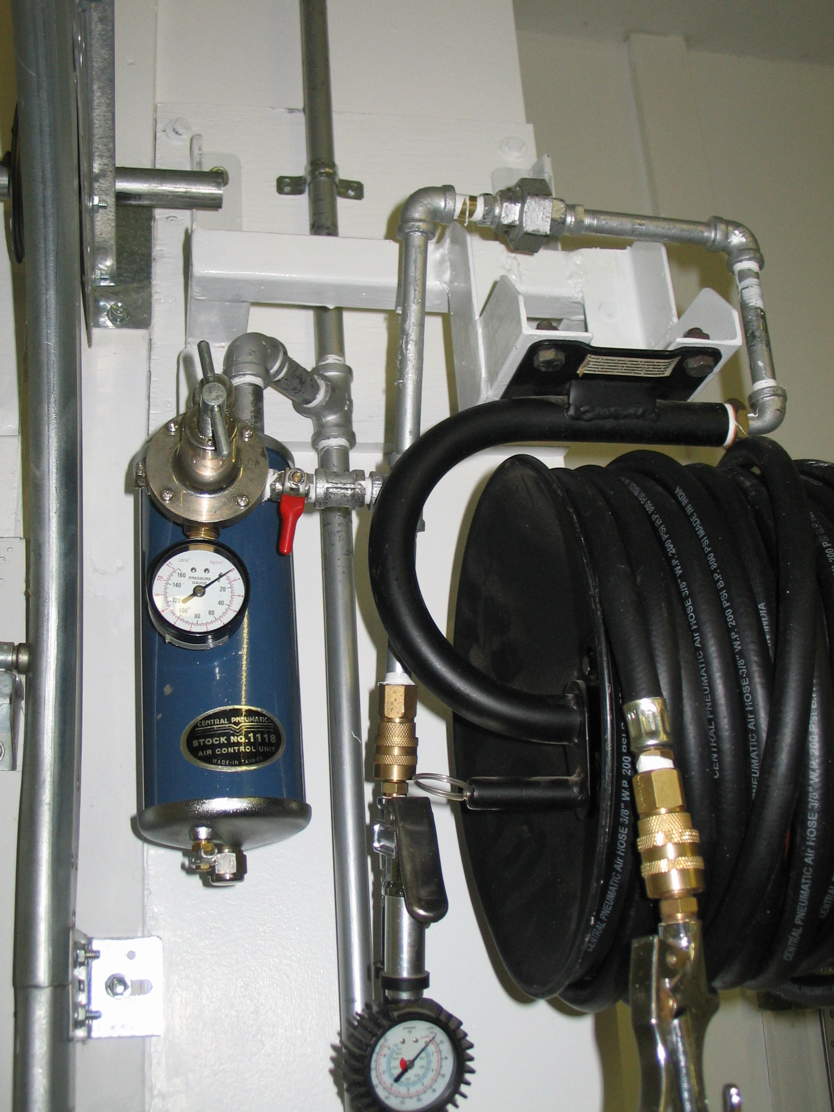

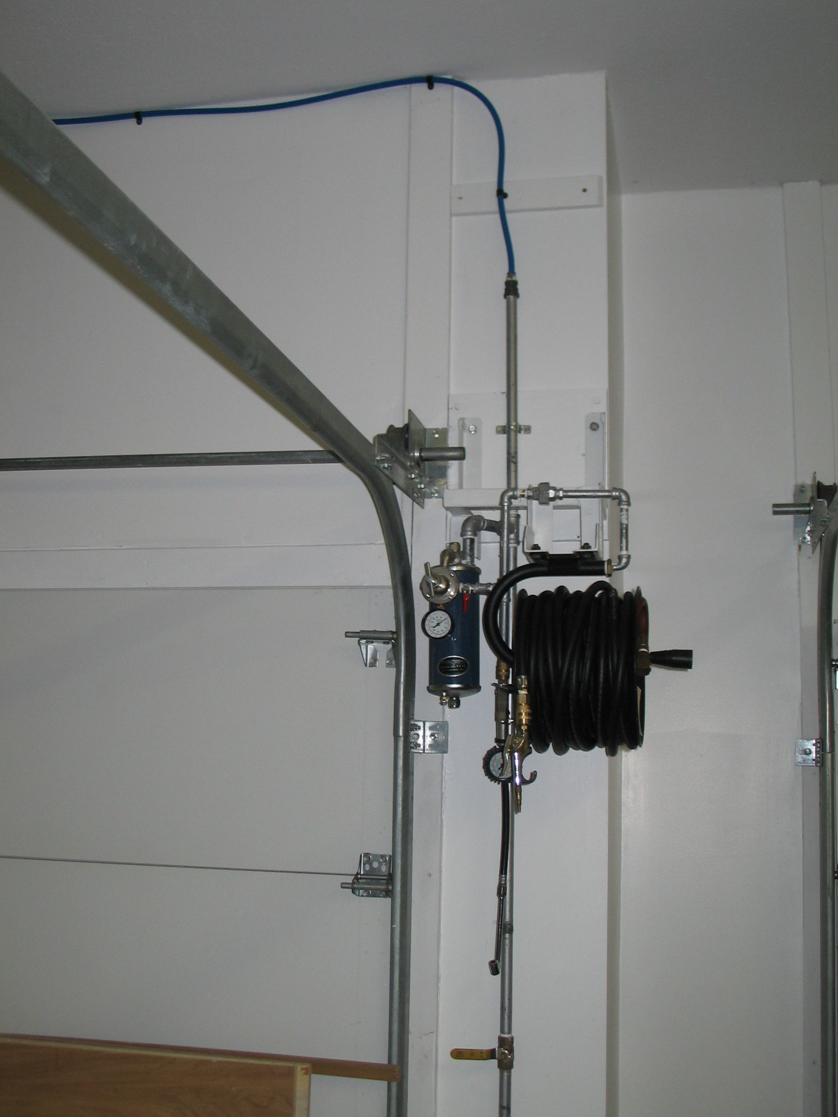

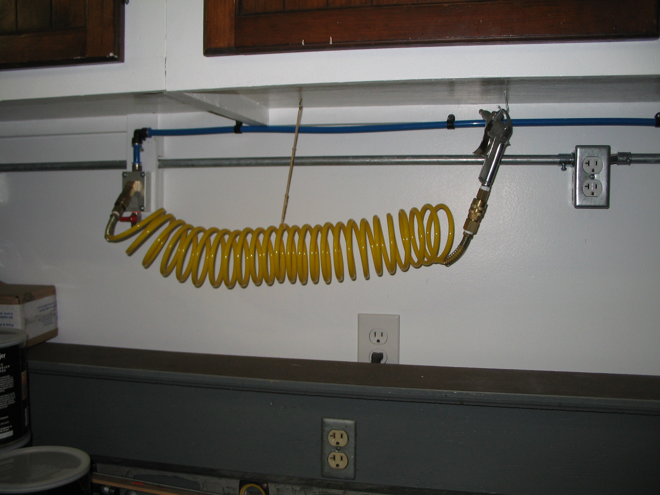

      Have the HF air garage system and it has been in use about a year. A drop was added using parts from Rapid-Air. I checked with Graingers and they carried the needed parts for the additional drop and they were individually less expensive, but they are sold several to a package and it was cheaper to buy from Rapid-Air + shipping. I did not check any place other than Rapid-Air and Graingers. I do believe the Rapid-Air tubing connectors are somewhat better, but the HF connectors are find for casual home use.
      I ended up with four drops and counting all of the connection points (valve, tubing connectors, quick disconnects, filter, hose reel, etc.) the total possible air leaks points is in excess of 130. With the main tank valve on and the system not in use the elapsed time between starts is 3 hrs. 40 min. I believe there are a couple of mixed automotive/industrial quick disconnects and when/if fixed should help a little.
      I use the shop air for general uses and also for a sandblaster, impact wrench, sander and the volume is there for home use. The price of the system was $100 ($80 with coupon) about a year ago and now that the price is approx. $60 without discount it seems a good buy. As a home hobby guy, I am well satisfied with the HF system and would do it again.

                    dewi1219 - wardprobst's reply about the system results being satisfactory if the compressor will supply the CFM the DA and HVLP requires is right on. The HF system is rated for a maximum of 150 PSI.
                    The galvanized pipe I used in one of the drops is a section of an air system I had at our previous home that was all galvanized. The shown galvanized section was used intact from the old place and I just used it as it was. Here again, I agree with wardprobst that a galvanized system would be less leak prone. I thought about all galvanized at our present home, but the price of the HF system helped make the choice.
                        CORRECTION!
                        I did not use galvanized pipe - sorry about the above info! Regular black plumbing pipe was used and was painted with some left over silver paint to help stop rust. Again, sorry about the mis-info - another senior moment on this end!!!
