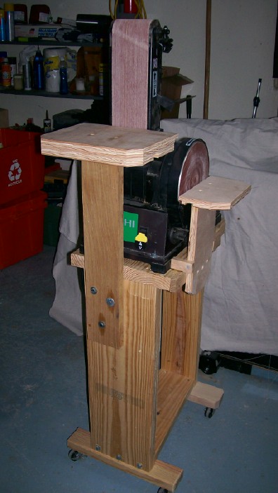

                            I purchased the machine when it originally came out. Two reasons.. I ran my Ryobi to death and I liked the cast iron table. I have run mine a lot and I have had two problems in the recent 6 months. Before I state them the machine is a hog and the dust collection is excellent.
                            Most cheap sanders have tables that are very small and won't stay in place when tightened. This one has a cast iron table and it looked healthy to me when I purchased it. Just recently the tightening bolt that holds the cast iron table stripped on me. And the tension adjusting nut would move slightly when running causing the belt to change track.
                            The tension adjust was a quick fix with a piece to duct tape to keep it in place when adjusted. No big deal. But.. I have never liked tables on any cheaper sander I have seen and even carries over to some higher $ machines. So.. after my bolt stripped I decided to fix that problem also with not only one that stays 90 degrees (I never use a sander to do angles so tilt is a non issue with me) and has a larger table.
                            Just a quick fix for me in both cases as I do like the machine better than any other cheap sander on the market. Good luck getting one for those in need!
