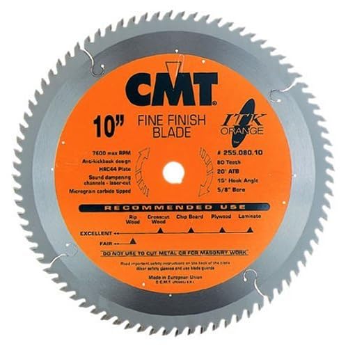

    How is this blade in comparison?
    http://www.lowes.com/lowes/lkn?actio...080&lpage=none
    I just recently saw that my Lowes is carrying CMT blades and I am thinking I need an 80 tooth blade for my miter saw.
        Good question. The regular ITK series is CMT's lesser line...still pretty good though. It's roughly comparable to the Freud Diablo line, but this one looks very different from the standard ITK series. Hard to know without trying it. The Infinity and the CMT have different tooth grinds though....the Infinity is a triple chip (TCG) with a -5° hook. That'll hold up real well, and excels at melamine, laminates, ply. The CMT has a 15° positive hook and is a Hi-ATB grind, which is typically great in plywood and ultra fine crosscuts but tends to wear faster. 15° is a bit on the steep side for CMS, but is ok...you could even use it in your TS. It's not recommended for SCMS or RAS.
        My concern is how well that particular CMT is made...if the Lowe's version is similar to the CMT ITK 255.080.10, it should be very clean cutting blade. If the CMT blade fits the bill, I'd be more inclined to order the 255.080.10 from Amazon "Market Place" (World Class Supply) for ~ $60 to your door...that way you know what you're getting. FWIW, I did have a CMT ITK 255.080.10 and thought it was a really nice 80T Hi-ATB blade....not quite on par with the Freud LU80 or the Forrest Duraline, but a nice blade.
