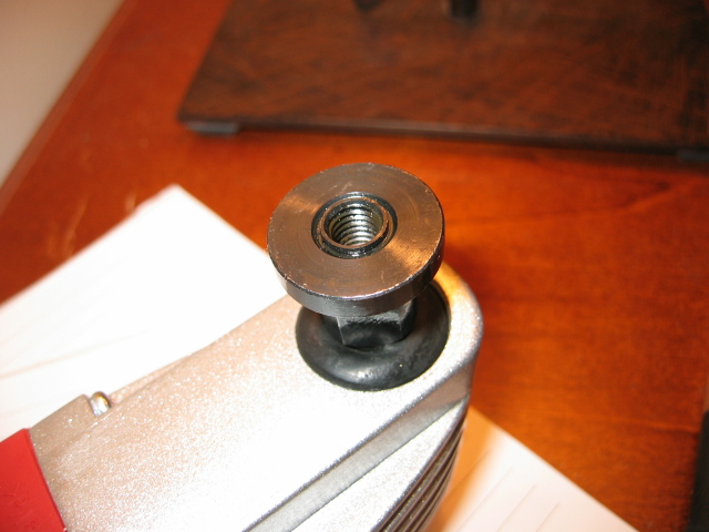

                                My local HF got a shipment of the Multi-Function Power Tool
                                #65700 @$39-20%=$32
                                I checked all 5 boxes and there were no pins in this shipment, Thanks OP
