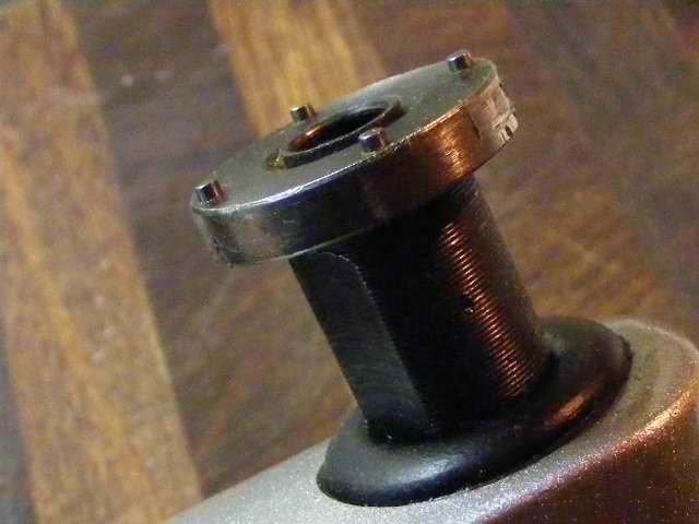

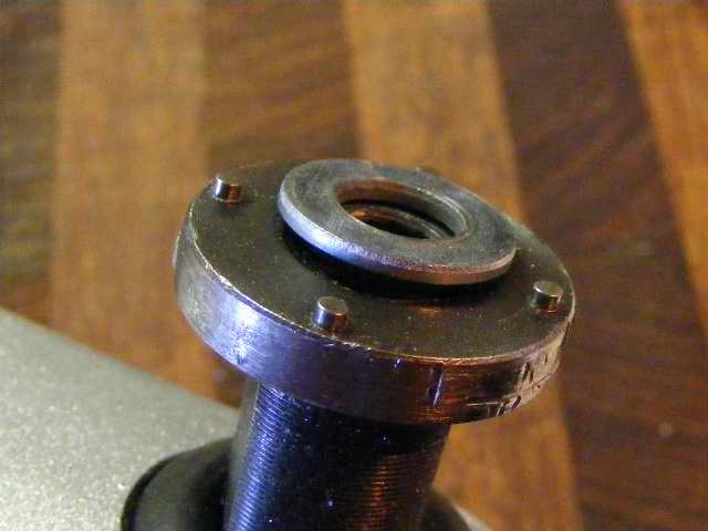

                    I'm sure it has pins, perhaps if you used another light.
                    Here is a picture.
                    John

                        The index pins were there on mine but I had to punch them out.
                        John

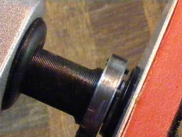

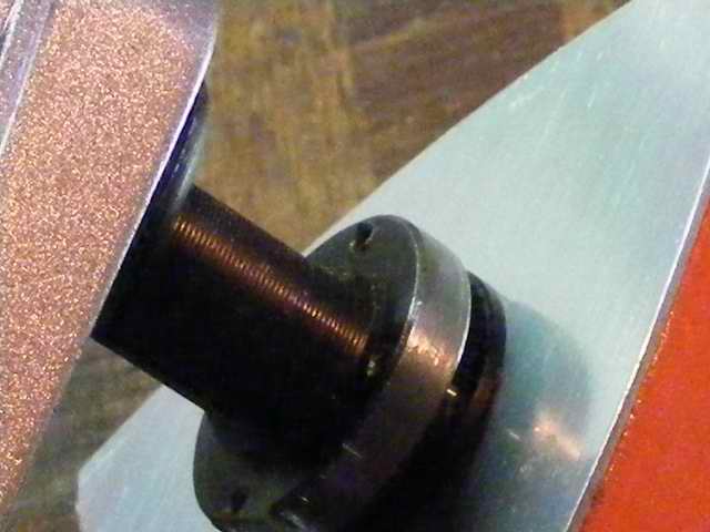

                        • Luckbox
                          • 371
                          • Holly Springs, NC
                          If you punched them out then how do you you use the sanding attachment. From what I saw ther sanding atachment was totally smooth with no place for the pins.

                            Luckbox,
                            I added a washer to protect the pins.
