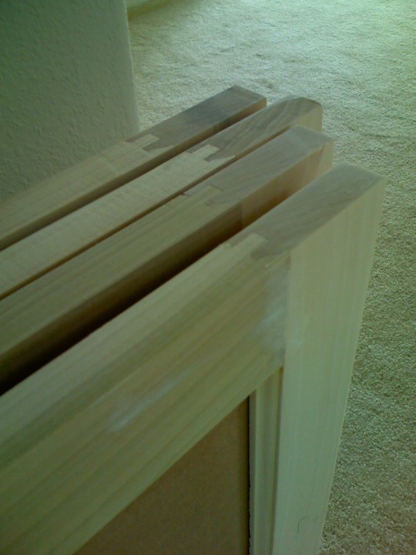

              I just used this set on my cabinets doors I'm doing for a built-in in the family room. Not bad for $40! A little more sanding that with my Frued or Holbren bits (on the profile - maybe just a fluke)...but well worth it in my opinion vs $100+ for a similar set. Pics below
              Gary

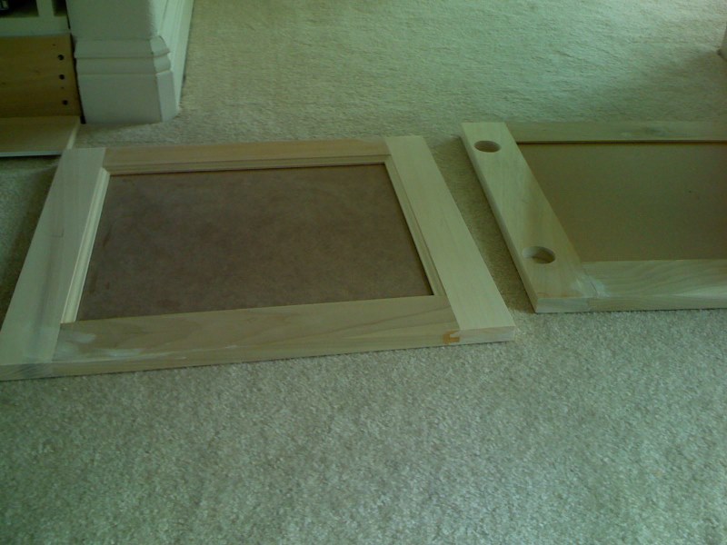

                BTW - you can see on the close up, where some of the screw up is (I may have to re-do this door). I used poplar for the R&S, and a 1/4" MDF panel. As you can see, the panel does not sit tightly enough in the groove to hug the profile. What did I do wrong? The panel is just floating. I know expansion isn't really an issue with MDF - should I have just glued the panel in place under the profile?
                Gary

                  Nice-looking doors, Gary. I like the style.
                  --Rob

                    From the photo of the door it looks like the grooves on the rail and stile may not line up perfectly. Seems (hard to tell) that the face of one is taller than the face of the other. If so the slight difference might force the panel to bend a little creating the gap you see. If the panel doesn't move forward all the way when pressed from the backside that may be what's going on with that door. Just a guess.
                    The profiles look fine. For $40 a set much better that one would expect. Thanks for posting the pictures.

                      did you say that the pieces (stile and rail) did not align perfectly after they were cut using the two bits?
                      secondly, is the center notch (where the panel goes) wider than 1/4"? can you measure it with a caliper?
                      i am asking because i am want to order the set if top two questions are a non-issue.
                      thanks
                      omar

                          Did this occur on all the doors or just one? I started with a cabinet door set from HF (never, ever buy those) and I had the same problem. After measuring the bits I found that the part which cut the groove in the stile and rail was .265" well that sure as h*ll won't work on a .250" panel. If all your panels are loose I would look closely at the bit, might be an odd size.
                          RAGS

                            interesting you mentioned the hf set, bill. i had at one time picked it up, but put it back because i wasn't sure of the quality. now i know. thanks
                            but i am still interested with what gary will come back with.
