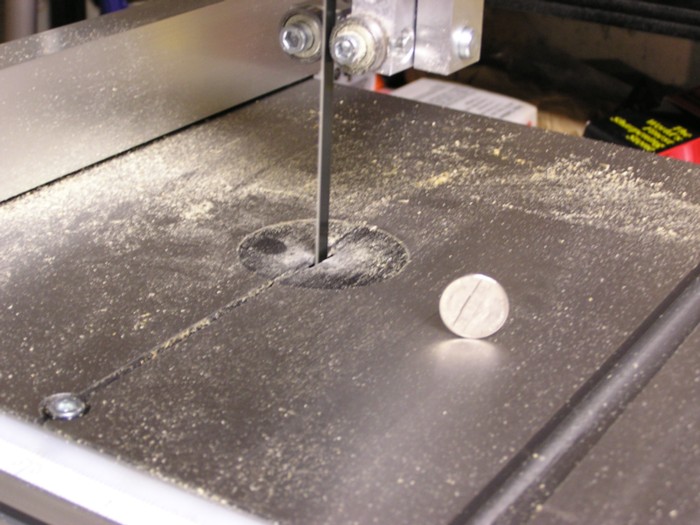

                            #28
                            I left mine at what it was set for tension and it seems to work fine for what I use it for. I put a mark on the inside so that I can use factory setting as a guidline in the future when changing blades or removing tension. One article as shown in the first link below said to expose 6 inches of blade and put moderate pressure from finger onto one side and it should not deflect more than .25 inch [though for this saw you can not go 6 inches]. I adjusted the guides and the tracking and it seems to run pretty good even passing the nickel test. Both pictures are with it running.
                            Steve
                            http://www.taunton.com/finewoodworking/pages/w00013.asp
