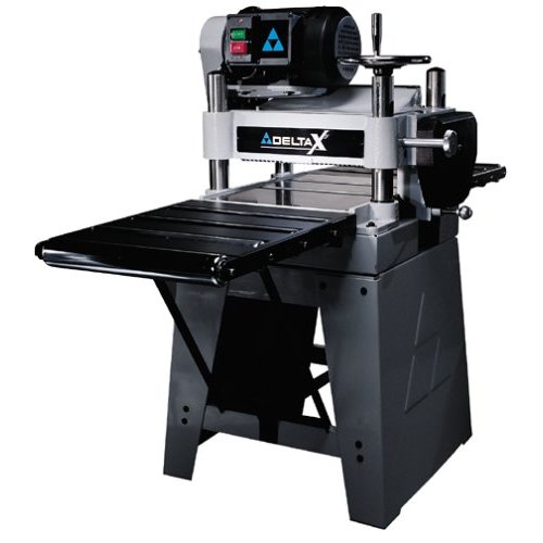

        I have a 450lb Delta Planer on an HTC2000. Works fine and the planer is the one tool in my shop that gets moved around a lot.
        What is the footprint of your jointer? WOuld you need the extension rails to make it long enough?
