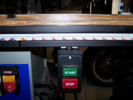

                    This is what I did. I used the Rockler Router table switch 83026. $14.99.
                    John M Varga
                      I used the switch and plug from a BT that was being parted out. Switch on the front and the plug inside the center compartment with the router.
