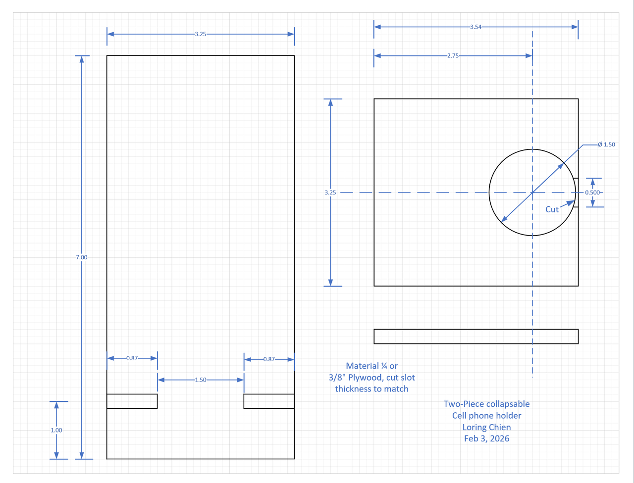

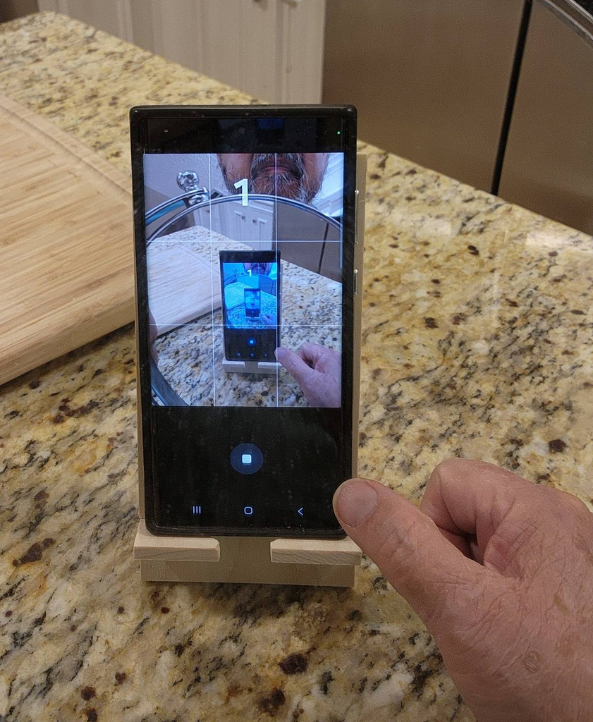

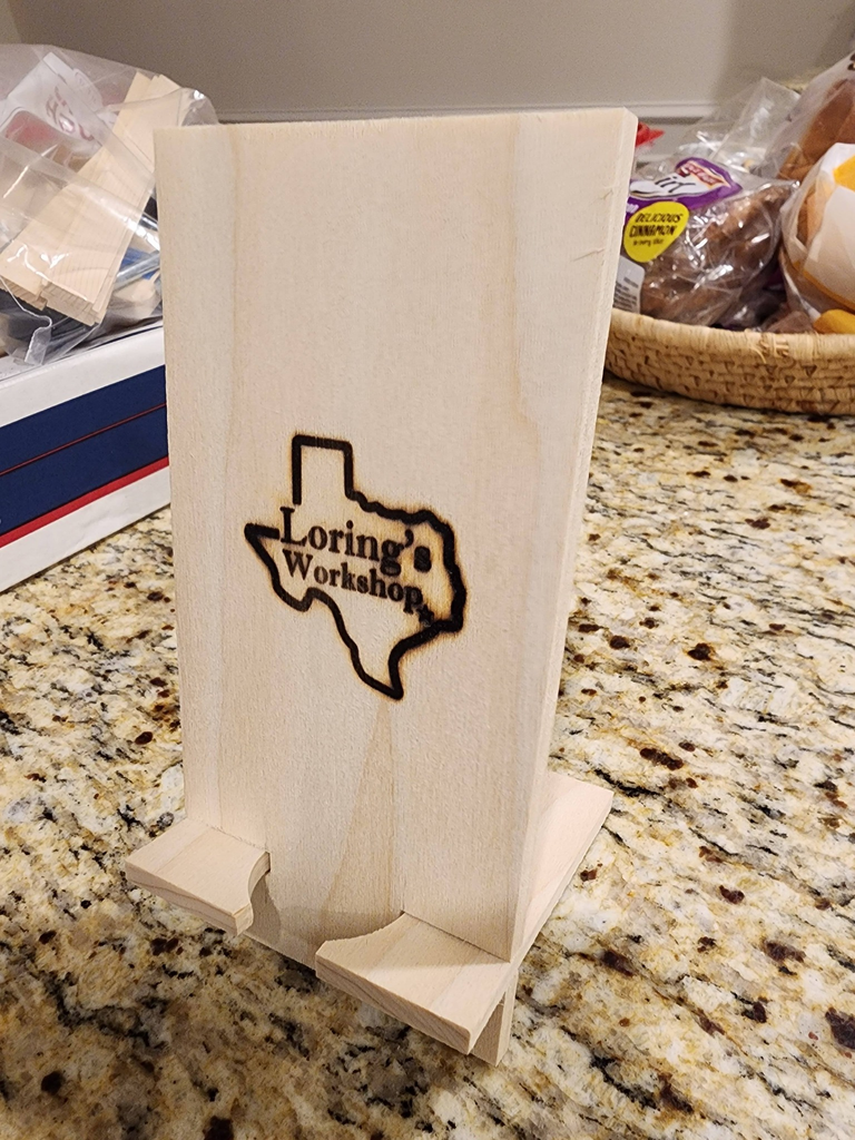

    Just did a fun little quickie project, took me a a bit of time tday before lunch and then finished after lunch. I saw the idea on a facebook reels and came up with some dimensions.

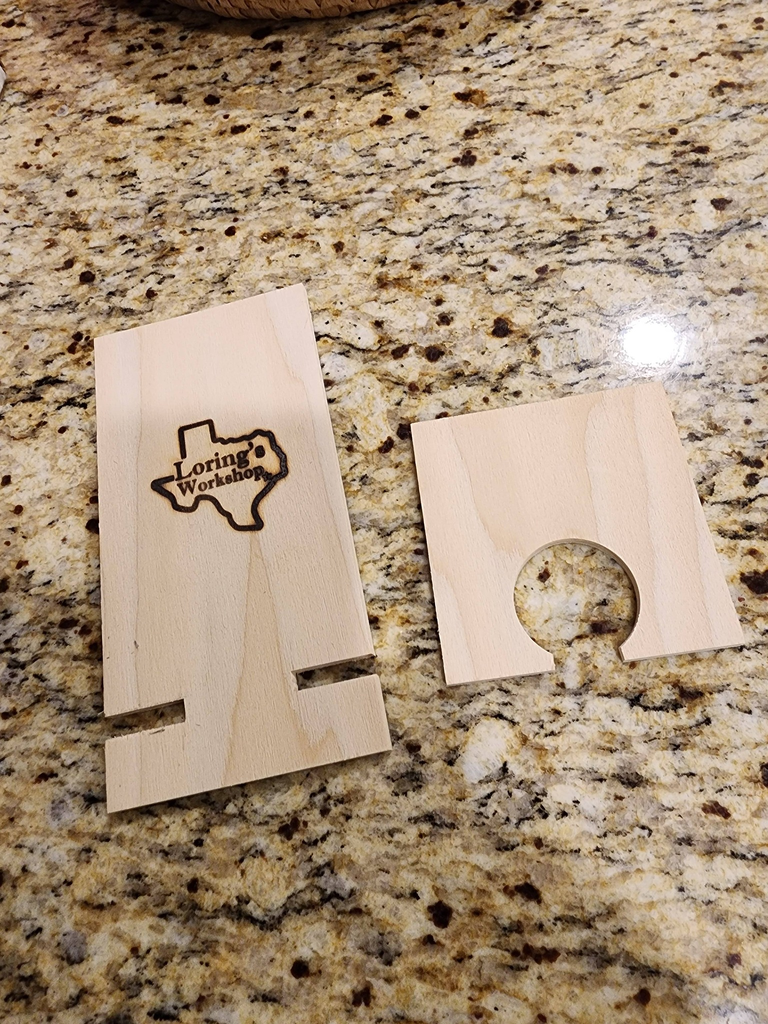

    It is a cell phone holder that breaks down for flat storage and has a slot so you can charge it while in the holder.
    I just used a piece of hobby poplar from HD that was 3.5 inches wide by 1/4" thick. It came in a 24 inch board so I could make 2 from one piece.

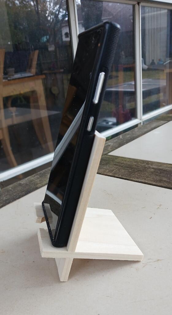

    Made one with a shorter back

    Click image for larger version  Name:	image.png Views:	14 Size:	207.2 KB ID:	862619I laid it out for 3.25" but the stock was 3.5" so both pieces are wider and the slots 1" long instead of 7/8"
    Cut the slots to match the actual thickness if using plywood.
