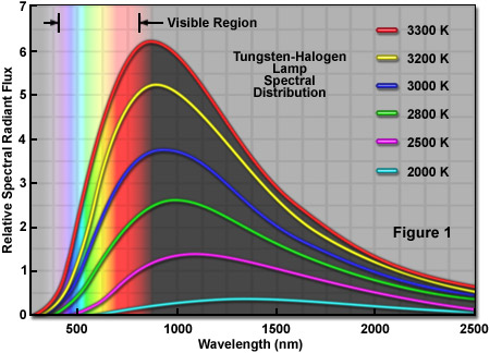

    The naming of spectral peak temperatures is related to what is called black body radiation.
    If you heat a black body to some temperature like 3000K it will glow orangish, at higher temperatures like 5000K it will glow whiter and or bluer.
    Think of a piece of metal heated very hot, first it gets orange, then it gets red hot, then white hot.
    As the temperature measured in K is increased, the peak emission wavelength shifts to lower wavelengths.
    Oddly, 3000K is considered a warm color and 5000K is considered cooler which is really opposite the corresponding black body temperature.
    The spectral peak emission comes from the black body temperature.

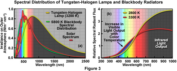

    To some extent the color of a tungsten filament heated to a temperature like 3300K gives light with a peak spectral emission we call 3300K.
    Note, as you make it hotter, the output in the visible spectrum increases.
    Click image for larger version  Name:	image.png Views:	0 Size:	143.0 KB ID:	857378
    So in general the peak spectral output of most lighting is what matches the peak spectral output of the black body.
    Regardless of the actual source.

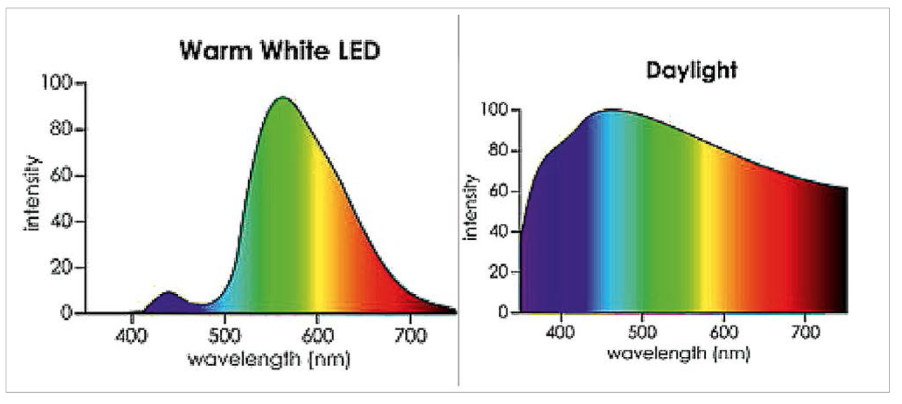

    Click image for larger version  Name:	image.png Views:	0 Size:	157.7 KB ID:	857379
    The huge amount of spectral energy in the infrared wavelengths that we can't see is why incandescent lighting is so darn inefficient; infrared is literally heat and all the waste energy goes off as heat.
    LED lighting has much narrower bandwidth so much less is wasted as heat. LEDs have actually very narrow UV bandwidths and most are used to illuminate phosphors which are excited and re-emit light over a visible spectrum according to the phosphor mix. That is how they get the peak spectrum at different wavelengths corresponding to what we call the K temperature scale. Note that the phosphors can be kind of peaky and not as smooth as the spectrum from black body radiation and control of those peaks gives rise to what is known as CRI which attempts to measure the spectral smoothness over very peaky lights which if the wavelength is missing can make the items being lit less attractive.
    Click image for larger version  Name:	image.png Views:	0 Size:	245.4 KB ID:	857380K color temperatures were of course first used to describe the output of tungsten filament incandescent bulbs - basically engineers can modify the thickness and length of the filament to achieve different temperatures at a given power level and affect the coloration of the light (as well as the lifetime - hotter burns out quicker with shorter life). As lighting changed from incandescent to fluorescent to LED the K coloration was kept to help match or compare peak spectral coloration of the light even though the spectrum was different.
