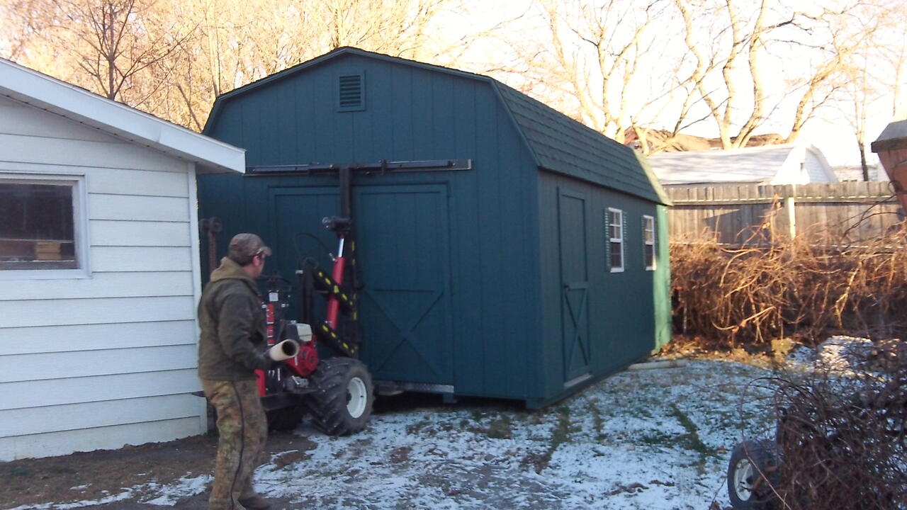

          How big is your shop and what is the general description of it's build. The reason I ask is that I have a 12 x 20 Amish-factory-built shed with a gambrel roof (barn-like roof). I've been delayed on getting it finished on the inside (insulation and dry-wall.) While I have all the tools in position, everything is temporary because I haven't found the time to concentrate on the interior finish and as you mention, it gets way too hot in the summer to work in there. (Like yesterday it was 96 degrees.) In the winter, I have a twin-radiant reflector that fits the top of a LP tank, and that works pretty well for me. I've considered putting in a natural gas wall heater, but then I thought perhaps a mini-split might well handle both heating and cooling.
          My shed is painted dark green so it blends into the yard better, but it sure does absorb the sun's heat. A mini-split around here are at least $2K or better, that last time I checked a couple of years ago. I haven't looked into it with any depth, but I'm considering doing it myself, if I can.
          So, that is my question.... is that a do-it-yourself opportunity or do you have to contract it?

          Answer to atgpaul,
          My interior walls are 76" high unfinished. The roof is 'gambrel' shaped, like an old barn roof, two angles on each side to peak at the center. I ordered it that way so I could have a so-called loft at each end. As originally built, the loft space at each end was 4 x 12, but I expanded that out another sixteen inches on each end and I doubled the loft floor, adding double 2 x 4 x 12. That way I could store eight-foot stock up there with three ft off overhang back toward the center of shed. Under the loft areas at each end, I have 76 inches from floor to ceiling and in the 10 ft long area at the center of the shop, the height is significantly higher because of the roof shape.
          I ordered this in mid-December 2015 and it was delivered about a month later. Built down in the south-western Pennsylvania and ordered from a local dealer here in our area. Price was $5392 including tax, delivery, and installation. It included two windows, fabricated side entry door and a double door at one end and the loft areas at each end as well as a small vent at each end. The ceiling and walls utilize 'LP Tech Shield" material with the ceiling incorporating a foil heat barriier. The flooring is also insulated.
