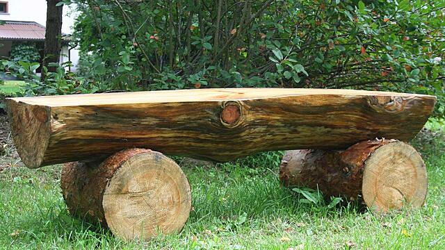

        My wife had an idea of making a log bench out of it, like this:
        Dunno if mahogany is good for outdoors, or how to protect it from the weather.

          Google sawmills in south Fla. , there are are more than you think in your area. There are a lot in central Fla. as well. Tampa area has quite a few. It might be worth it to haul them a ways to get some good lumber. I definitely would not waste 8-10 feet of logs to build a bench like your photo. Specify that the Sawmill cut you enough 4” thick slab to build a really nice bench, and you will still have enough wood left for projects.
